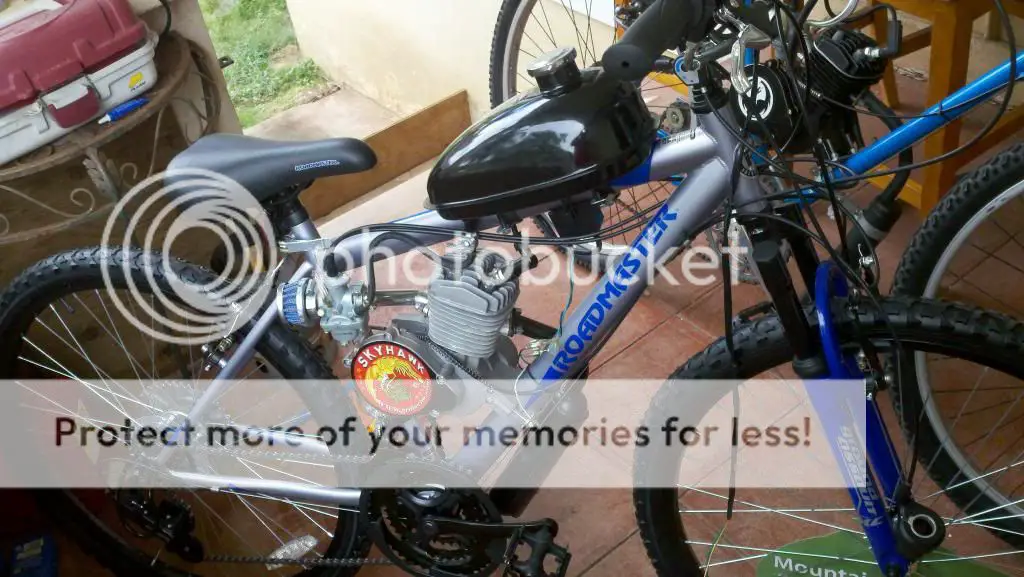

Hello, I just put a Skyhawk 80cc (66cc) on a Roadmaster Granite Peak from Walmart.The only mod I had to do was dent in the downtube a bit (very little) for the front motor mount studs to clear. I like how the motor fills the frame really well. Had to face the head (plug) forward to clear top tube as well. Offset intake manifold helped too. Built this for my uncle This past Saturday...took about 5 hours with lunch break :)

Yay!
dnut
I see it's the skyhawk. The reason I had a problem was because it was a ebay china girl with a standard carb. I had a problem clearing the frame.
Nice job, but be very, very careful. These bikes will fall apart.
Best luck!

Thanks CARider!!!Yes, Skyhawk...luckily it comes with an offset intake. The CNS carb is crap!!! Can't get full throttle power but it does idle and run...good for break in period lol. This bike is for my uncle and he'll probably be fine with it's slowness for now until his grandson grabs it hahaha!!! I mounted the rear derraileur grip shifter to the left side handle and got rid of the front derraileur grip shift...(left the chain permanent on the largest chain ring). I couldn't figure out how to disassemble the grip shifter :S
Alohas!!!

I have a (broken) CNS and it does fine. Likely can't get full throttle out of it because you're running break-in gas. I can get 32 out of mine with the way it's setup.
You can disassemble the grip shifter by pulling the two halves apart.
