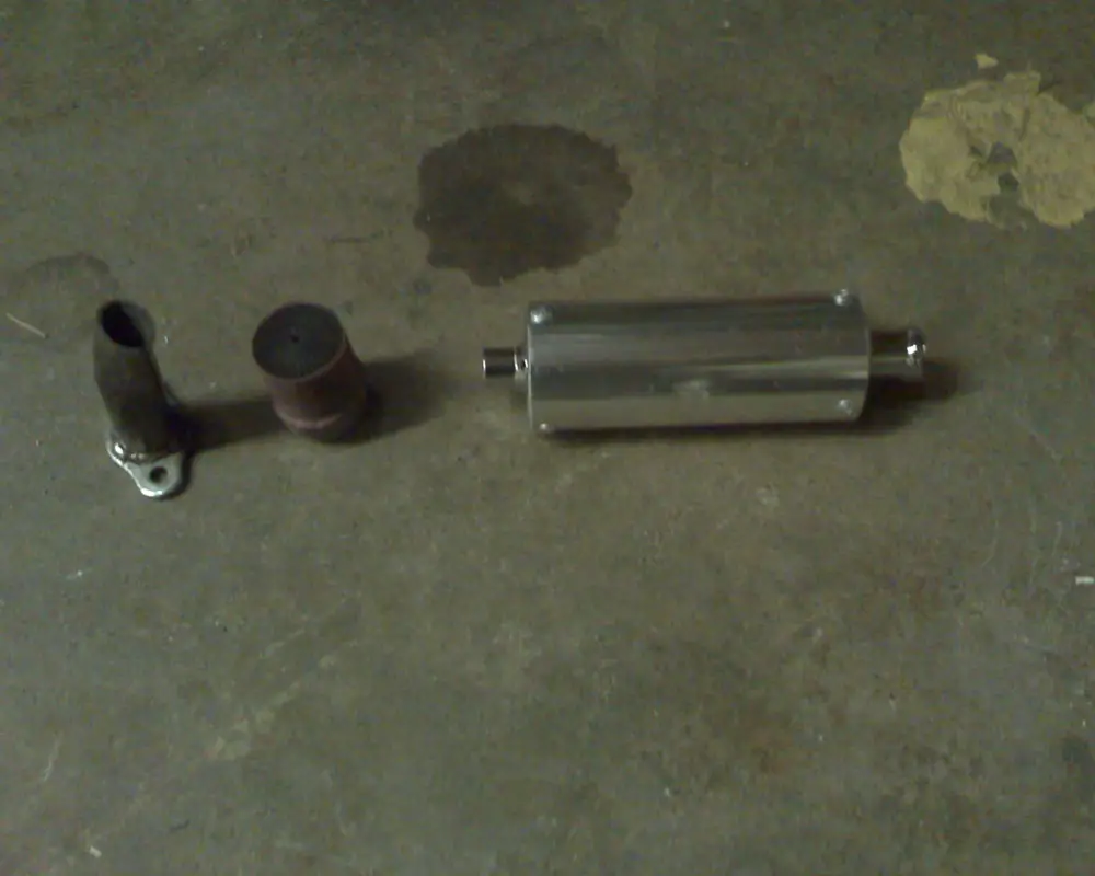

Mine did the same thing as silverbear's and I pretty much did the same thing except I put the muffler on the end of a pocket bike pipe after I cut the cat out of it.
You can see from the first pic that the chrome has burned off the middle of the muffler.
The middle thing in the 2nd pic is the cat which sits just before the burned spot inside the muffler.

Actually everything back to the muffler is from the pocket bike pipe, I just cut the pipe right at the expansion chamber, flipped it and re-welded it so it followed the curve of the frame. Doesn't burn my leg at all since I wrapped the whole thing in header tape. Although I do miss the sound it made before I wrapped it, it had the nice tinny pop from the expansion chamber like a dirtbike has. lol
As far as a catalytic converter getting red hot, I would think that would mean the thing was working properly since the platinum media has to get over 600º to properly convert CO onto CO2. I remember cars in the 70's had warnings on the sun visors about parking in tall grass because the cat could cause a fire.
