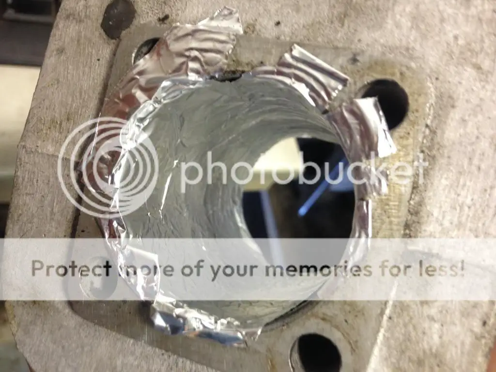

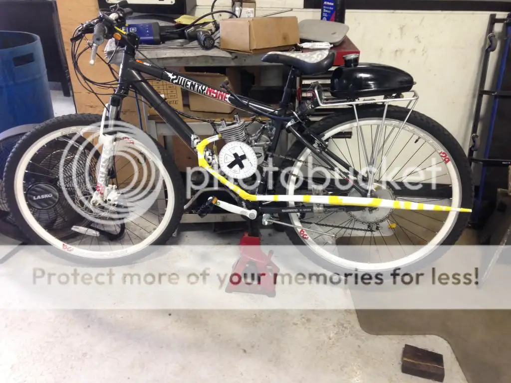

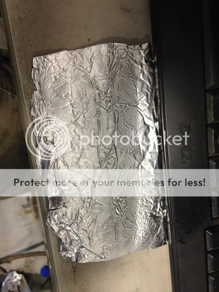

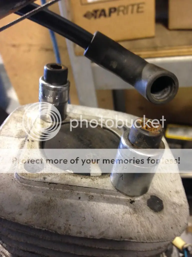

the time has come for me to throw away my gutted CG muffler and build myself my own creation. i downloaded the 2stroke exhaust wizard and will base my exhaust of their calculations. i wll be updating this as i go.
measurments (that i would like to have you guys critique as nessasary):
skyhawk gt5 66cc.
bore 47mm
stroke 36mm
exhaust port degrees: 183
transer port degrees: 122
exhaust port + gasket lenth 19mm
