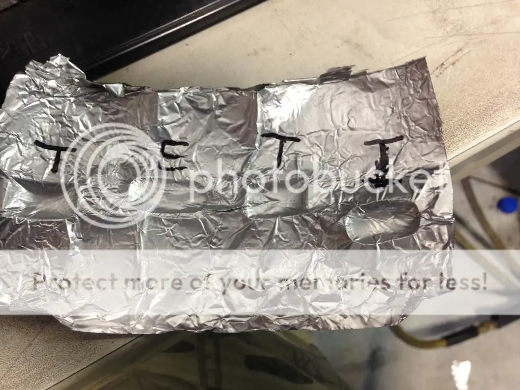

next i took cooking foil
and lined the cylinder with it
followed by installing a rubber glove inside the bore and blowing it up with compressed air, this formed the tinfoil to the cylinder wall nicely. i still had to take my finger and imprint the ports a bit more to get a good shape. im only worried about the size of the ports, not their locations in the bore and therefore dont care it things move around a bit.
now iv got this: Transfer, Exhaust, Transfer, Intake
the reason i needed do all this is because i needed to know the shape (not hard to tell anyways) of the exhaust port as well as its height and width. all this info is needed for the exhaust wizard.
