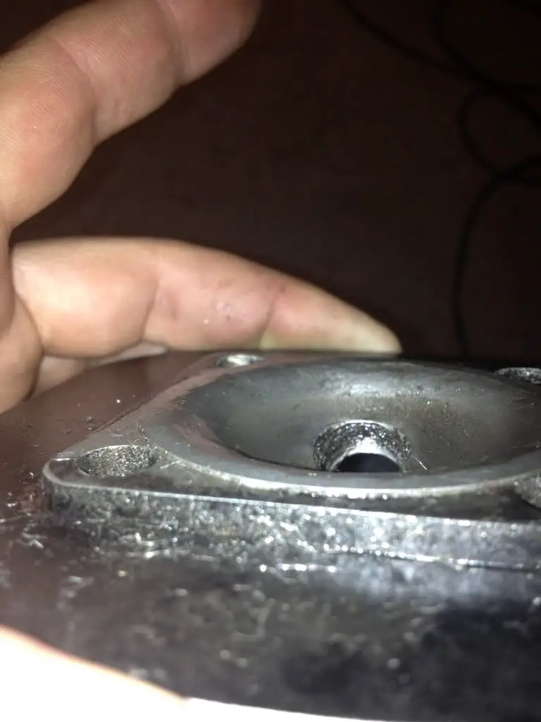

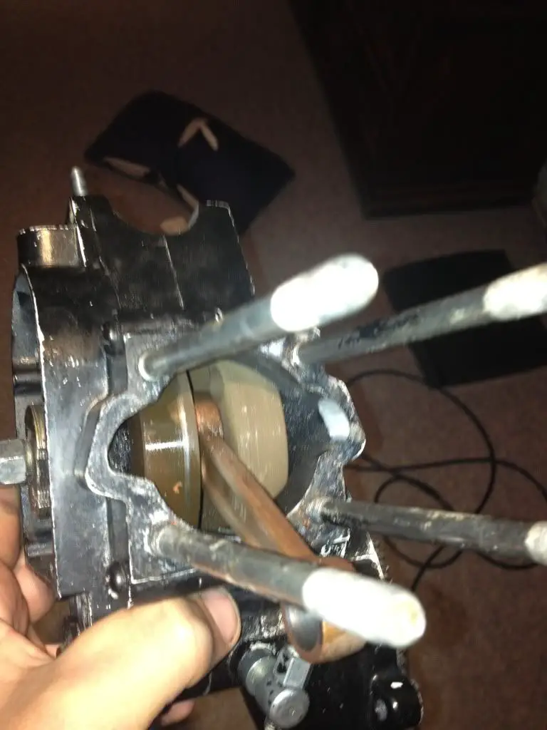

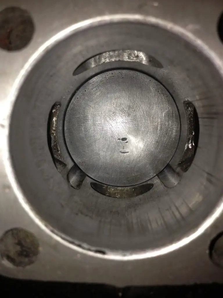

well i took my engine apart to take picture for you guys only to find pitting of the head and scroing on the jug and the piston was pretty much ok
so heres my porting now
2.5mm up ex 5mm wider
2mm down in 4mm wider
fixed tran ports

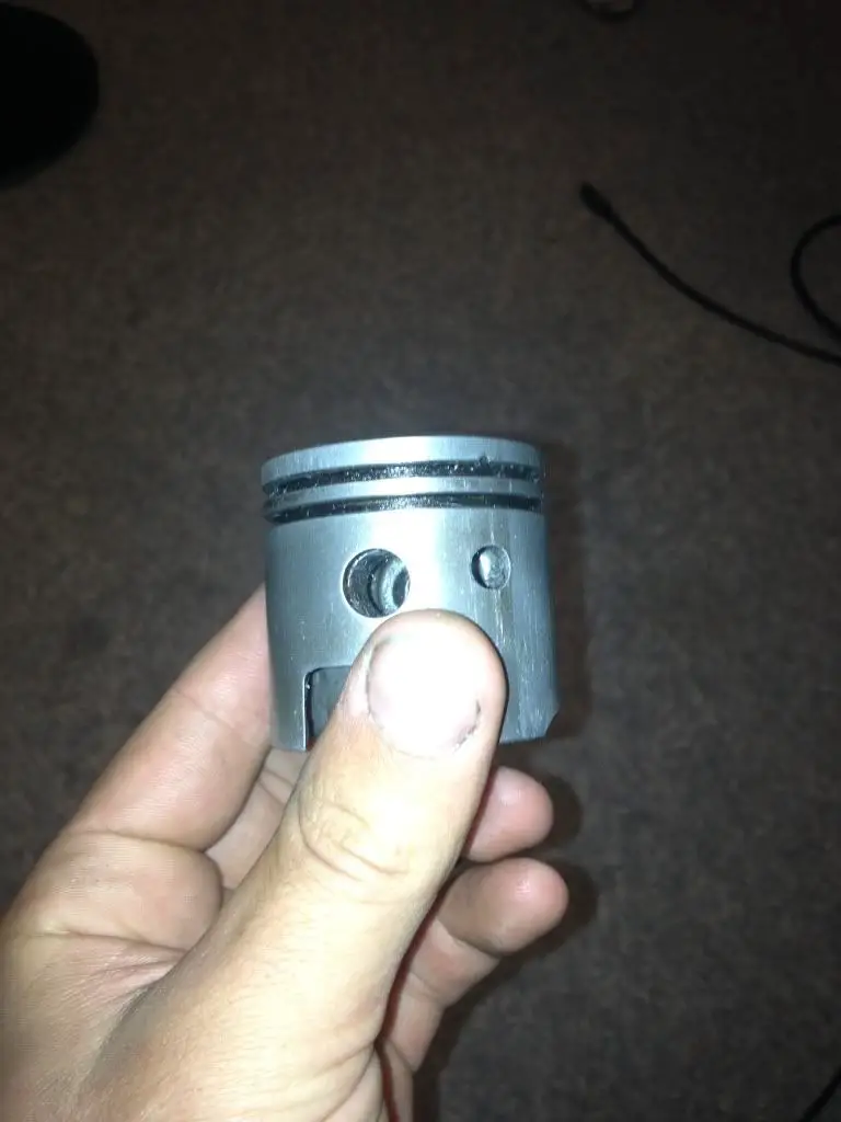

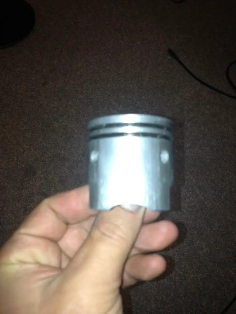

2 4mm wide boost ports with 2 4mm hole in the piston
port mached with dental paper so it 100% perfectish
the the flat spot on the head was milled off so i could run no base gasket and not hit the head this mod made the bike a lot harder to start (wheel sids alot)

Hi. Uno if the boost ports extend to the bottom of the cylinder the feeder ports in the piston arent nescessary. Cheers

I can't help but notice that you don't have a squish band on your head.
Polishing your combustion chamber on the stock head is a waste of time.
What is the point of doing these "crazy" porting mods if you don't have
very basic 2 stroke parameters done?
i know but there not much room in the boost port as it round and only 4mm deep with sounds a lot but if you saw it, it would make to add a hole aswell.
the flat area that gose past the gasket area needs to be rounded out with gives you a real squish band. if you look past the carbon and pitting you will see my head has has the flat area on the stock squish band removed on a mill to give the engine a proper squish band and allow me to run no base gasket boosting the conpression big time
sorry i should have took a picture on it right of the mill and new usflg
