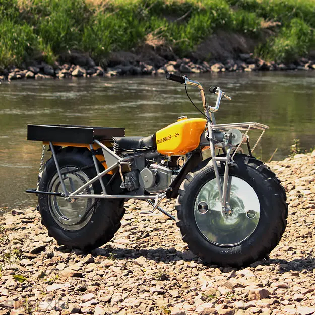

I've got a 1969 Rokon Trailbreaker 2-wheel drive off road motorcycle. These came with Chrysler (West Bend) 820
(134cc) engines. These were produced for many years and used in all kinds of applications; chainsaws, minibikes, marine engines, Rokons, generators, etc, etc. They're beautiful engines. Stock they produced up to about 9 HP but, customized they could produce up to about 25 HP. They came equipped with a diaphragm carb that could run in all orientations. I could even be submerged.
While the Chrysler 820 engine looks a lot like the Chinese 80s, and is about the same size, the 820 differs in that its not a piece of crap. These were nicely made 2-cycles. They were very prized as gocart race engines.
You can still find used 820's out there but, there are also a couple of domestic companies making newer versions.
If you're looking for a nice 2-cycle this is my suggestion. Best of luck.
