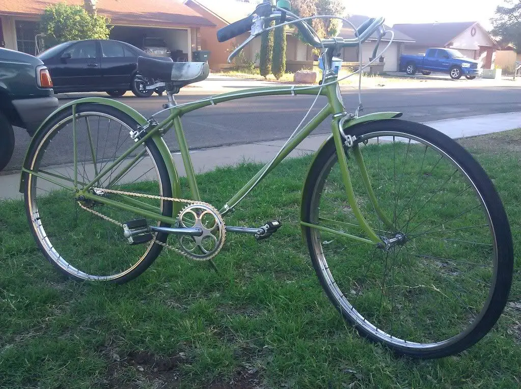

hey wats up guys, i have been working on this bike for 2 years now and finally got the bike running it idles good but it cuts out on the top end i have to hold the choke to get any top end, i moved the clip up and down and found it works best on the second slot from the top, im thinking i need to re jet it or break it in more any suggestions with any of the bike would be appreciated

i forgot how much fun these are i never had one for my self so im supper stoked im going to paint it this color it reminds me of a pea shooter

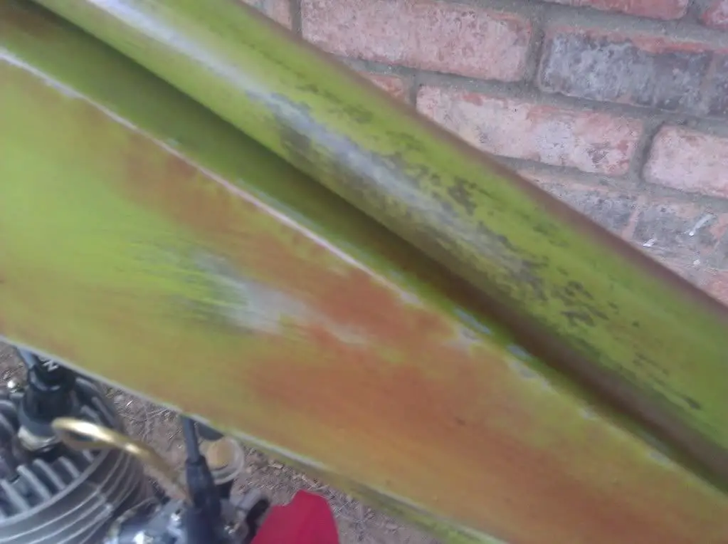

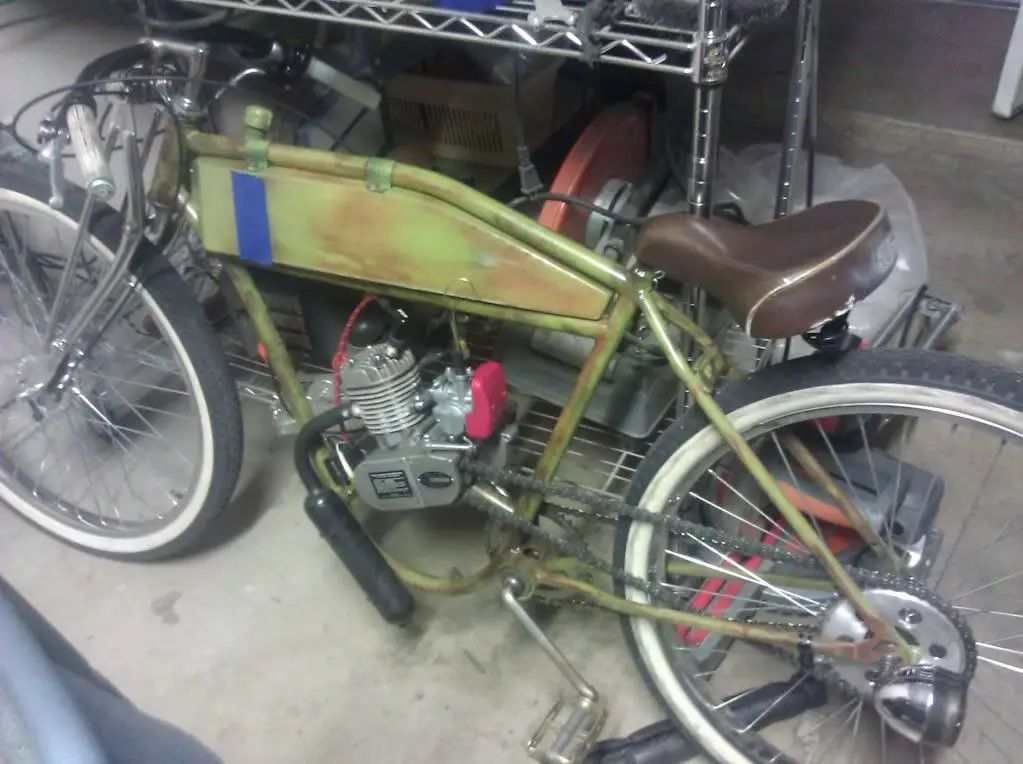

its painted, i went for a antiqued look, its running way better with some miles on it,the tape is on their cus their is some pin up ladies on the tank

check out the seat,looks way better i think, i also made a air cleaner from a tuna can
.crt.
This is getting to be a wicked-cool bike! I like the "Excelsior" green color scheme. (And I'm glad I'm not the only one who thought a tuna can would make a good air-cleaner cover. Clean that thing out THOROUGHLY though, unless you're not afraid to make a big stink. ;) )
