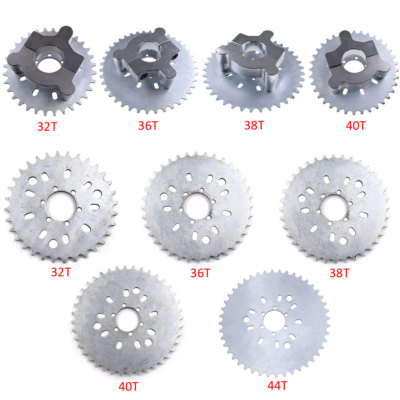

Yeah, 18 tooth is asking quite a bit of these little engines unless you have done some major mods. The engine just won't pump out enough torque for 18 teeth especially when going slow, just not enough low end. I would recommend moving up to a 28 tooth sprocket at the minimum. If your wheel won't take the sprocket you might be able to use a sprocket adapter depending on what wheel and spoke count you have, maybe something like this but make sure you measure your hub to get the right size adapter:
