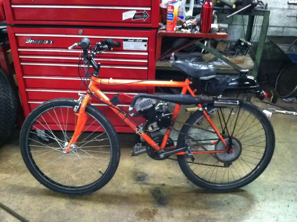

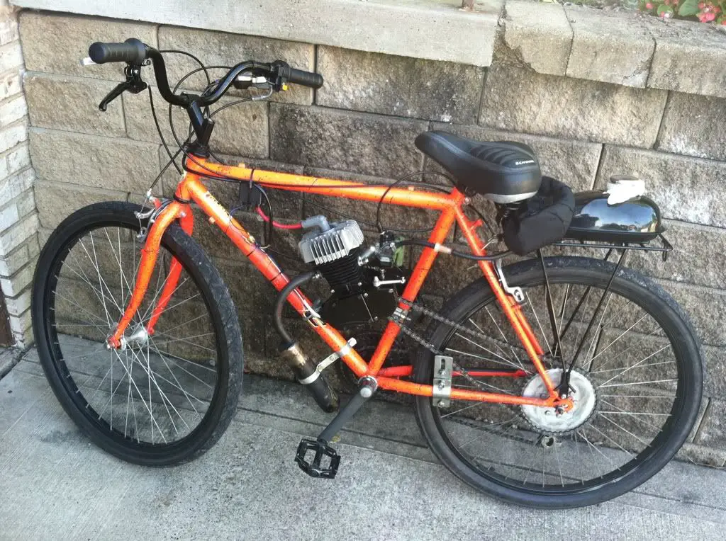

my bike, seen here in its first incarnation
it's definitely been around the block. i beat on it pretty hard for about 2000 miles, and i lent it to a friend while i was fixing his car and he put about 300 more on it over the winter. in the salt.

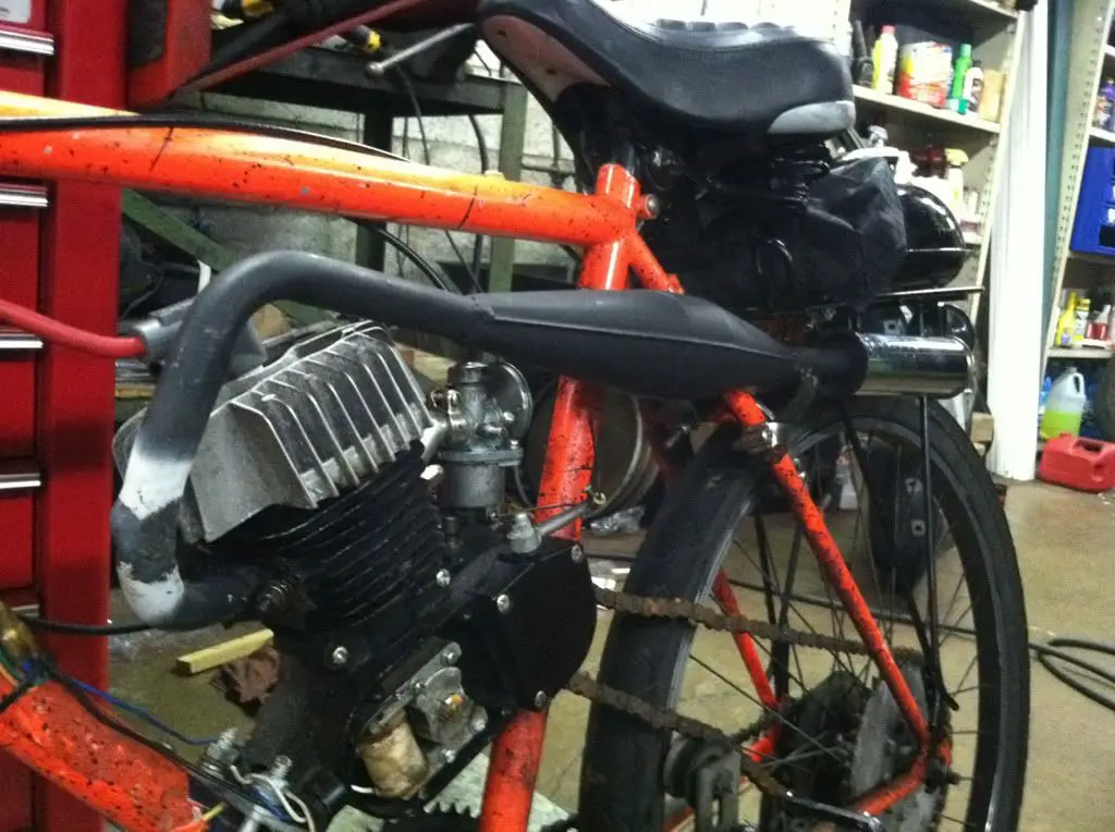

while being abused by me, i put two new clutch cables, rear brake pads, and new grips on it. that was a summer of commuting and going anywhere else i had to. the exhaust broke (and i welded it back together) several times. the muffler finally escaped while my friend had it, and it was returned to me without it. didn't bother me, i had other plans...
so currently, i need to:
fix the paint on the pipe where i modified it to fit
two new tires
adjust rear brakes
new ignition coil
new chain
clean everything
i also wanted to make a nice intake for some kinda crazy carb, but im not sure where thats gonna go yet.
anyone know where i can buy just a new engine, preferably an old grubee starfire gt4? i cant find any good ones anywhere these days...
more to come.

yeah my chain has seen better days, as i said, my friend used it to commute in snow and salt. he never oiled it. it was the cheap chinese chain that came with the kit though, and it was due for replacement anyways.
i like the exhaust pipe,i installed one like that but mine runs out the other side of bike,i wish mine did like yours,i had to move carb & intake pipe to the other side to get it to fit.migght have to move my tank back to the luggage rack like yours,my fuel line is really close to the muffler.
