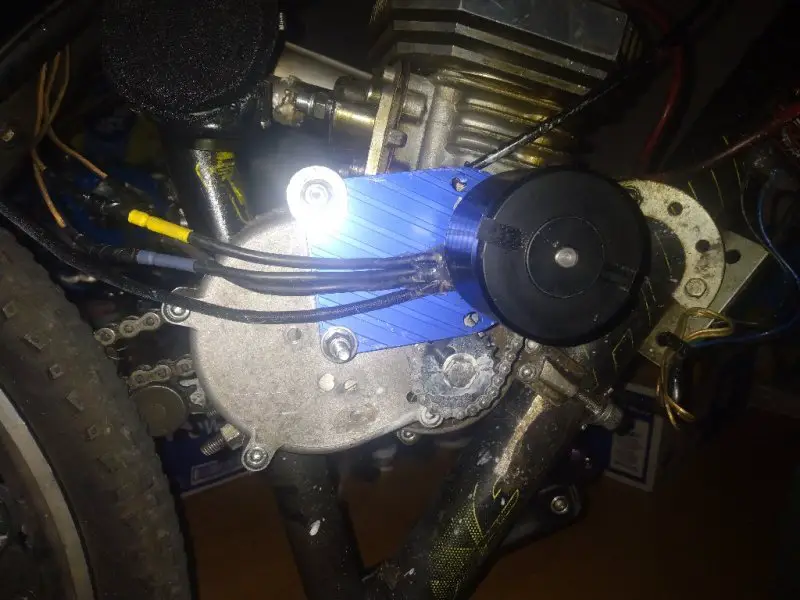

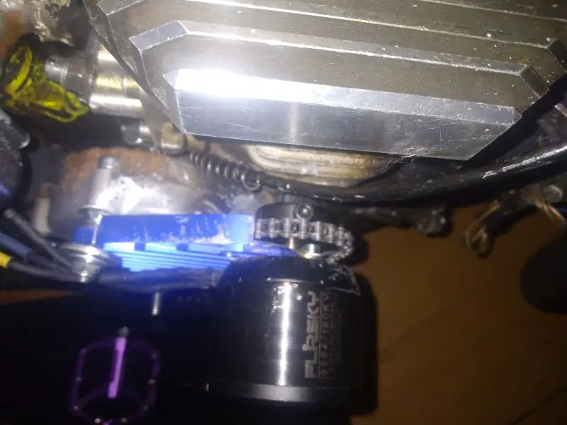

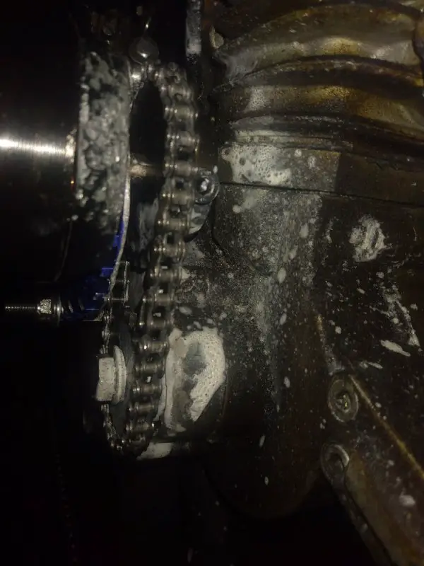

My bicycle alternator with a BBR magneto cover as a mount plate for the electric scooter/skateboard brushless motor as a 3 phase alternator.... Ran 2 miles today.
Don't mind the lithium grease!
It poduces 18.1 v DC with a 3 phase rectifier!
I have it on a Buck coveter/USB to power my electronics.
