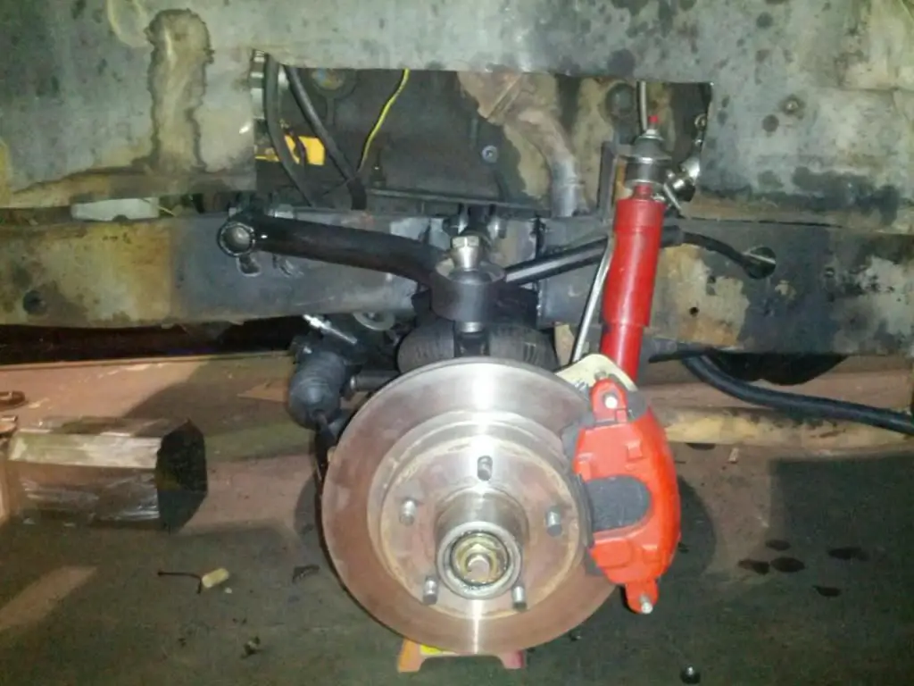

My 1959 ford f100....shop messed it up
please tell me that the frame behind where the upper balljoint and bag are was fixed by welding and a fish plate on both sides and the rear or the truck where they cut the frame so now the body lines of the box no longer match with the cab
Just another Example of doing work you do not have the skills for.
Blake thank your lucky stars bud that you did not drive it and have the work fail on you. Sue them for every dime the shop has and put them out of business!!
I hope that frame rail was boxed on the back side , I agree with yank to a point , sue them dont put them out of buisness but teach them a lesson they will never forget , so they dont kill someone by doing work they cant handle .

They did NOT cut the front frame its still straight and original. They also DID not box the frame either. Law suit filed september 5 is my court date.
Better business bureau, Los angeles consumer affairs, and Bureau of automotive repair all involved.
Bureau of auto repair informed me that under california state law any shop working on cars needs a valid ARD registration which this shop does NOT. im learning new stuff everyday about what to look for in the future etc. Its been a learning experience.
the shop that did the work is http://sikfabrications.com you can tell by their site that is not like I went to a ****ty shop that has no resume. The cars they have on there and the pictures of each build looked great. I did do alot of research so its just a bummer.

I checked out their site , a good web designer can do that in their sleep, an most of those vehicles have kits available that JUST BOLT IN , not to mention most of them are "new cars" , what your not seeing is what those cars could look like underneath , candy paint , chrome , an big wheels tend to grab the eye .I guess a lesson in suspension geometry an structural repairs couldnt hurt them as well as a class in advanced welding.I hope you get a favorable judgement .
