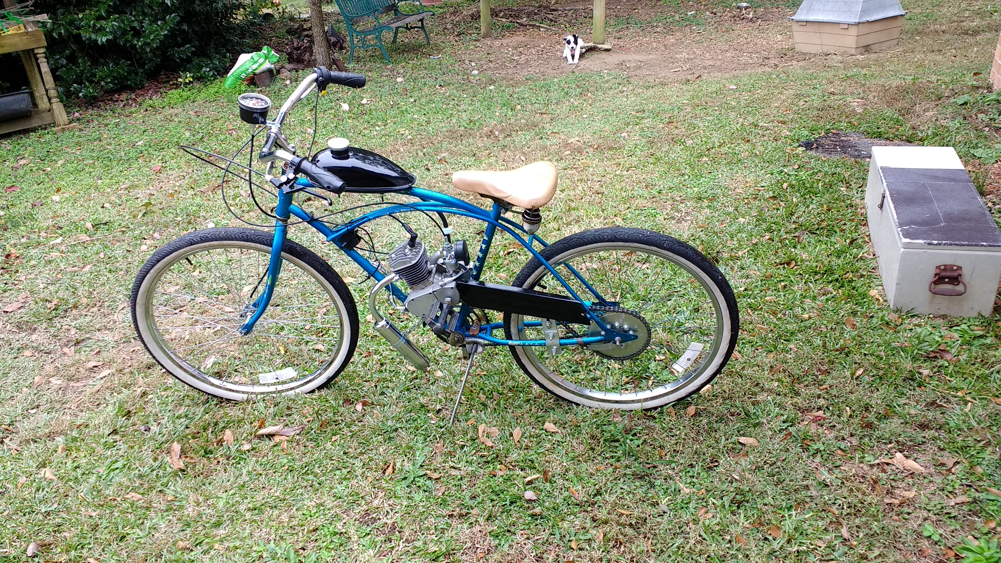

Thanks guys. A couple of notes. I think I was way wrong on the age of this bike. I now believe it's more of an early '90s Murray.
But that's OK. I like how it's turning out. Still waiting for my brakes to arrive. In the meantime I'm riding it with just the coaster brake.
I'm going to start with a rim brake up front. I'm ALWAYs reaching for a front brake that isn't there, lol.
Anyway, here is a picture of her as she stands now. My "Speedy Blue".
