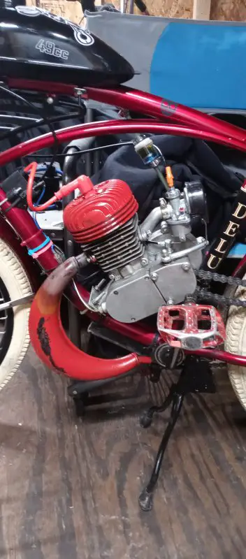

How's your S/P look Gotta pic?
It rolls perfect with clutch pulled in. When clutch isnt pulled in. Wheel will eventually turn instead of drag, but it starts and runs fine.
Sounds like a tuning issue, you may need to raise the slide in the carb a bit so that when it's at idle more gas will flow to keep it going.
