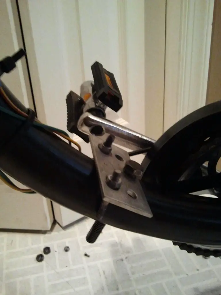

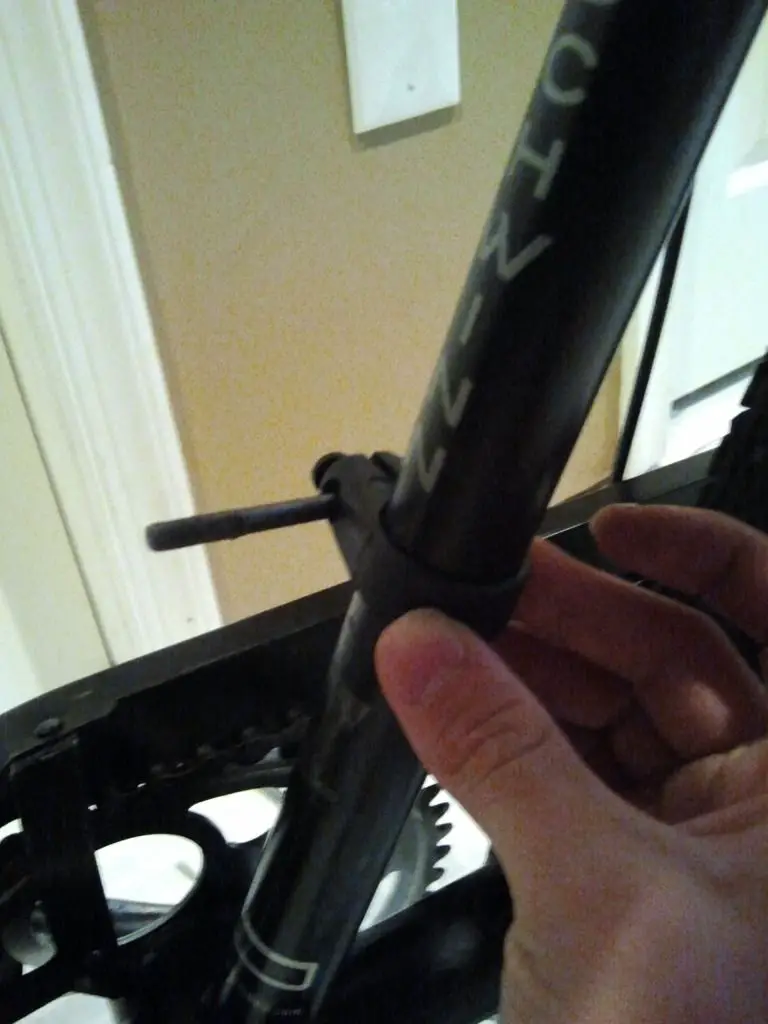

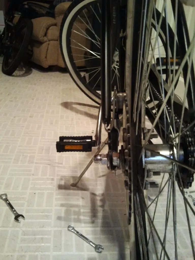

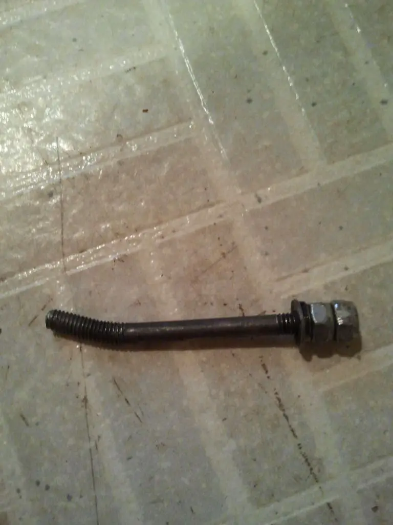

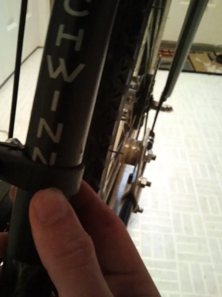

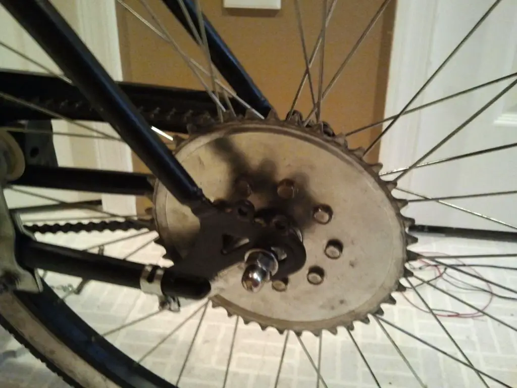

Anyway, it's picture time, so I can explain things:
First up, my rear tire:
Picture of it from an angle:
My front mount:
My "new" rear mount:
My theory suggested it would clear the chain, which it did:
Hopefully this clears some things up
i think your problem is the front hole you drilled in the frame isnt 100% strait and that rear mount is why it ripped off that wouldnt work its not strong enough and would want to twist on the single stud because the engine isnt fully on the frame and clamped also im worryed about the plates in the back wheel not being flat together meaning that it isnt tight enough
