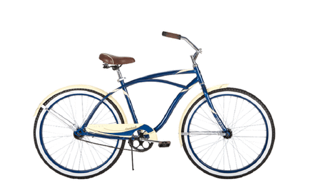

The frame is already 10" longer to accommodate the tires and there is plenty of room for an engine in that beast. You're looking at that like it's a 26" bike. Here, this should give you an idea of how big this is compared to a cranbrook
I don't know, my unscientific measurements based on crank length, and handlebar grip,comparing between the two frames, shows the monster cruiser is still very narrow by the bottom bracket, and you run into the cross tube as you raise the engine higher.
I scaled the two images so they are the proper size as if you saw them both sitting next to each other, those aren't just two random images made into a gif.
*edit* I used tire diameter to scale them so though not exactly accurate since cruiser tires are usually 26.5" dia and I don't know the actual diameter of the 36" tires on the monster, it's as accurate as one would need for scaling and guesstimation purposes.
I thought they were scaled to each other, that is why I used things that I thought would be the same size, like handlebar grips and possibly crank length.
