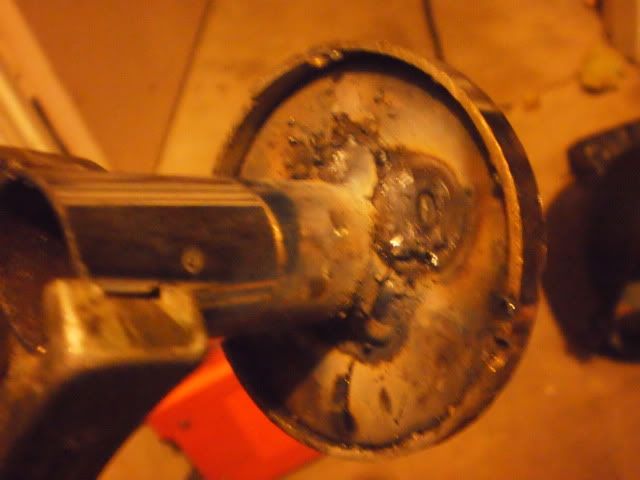

ok so, i changed to a larger muffler on the back of my expansion chamber which led me to lose 50% of the power in my bike.... Not good. So after a bit of a chat to some guys on these forums ( you know who you are :D ) I got to work
this is what i was greeted with when i cut it open...
Needless to say it was a bit restrictive so i set out to fix that...
