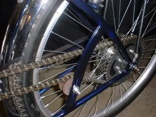

I have looked around for an idler chain tensioner kit of some sorts.
The one from ridley motor cycle is beautyful but the price is insane at $175
The one like kings motor bikes offers hurts your eyes but not your wallet at $ 10
Is there something in between that respects my wallet as well as my eyes?

If you've horizontal dropouts you may not need the dreaded tensionor at all if you can get the chains to match... xlite and bairdco would be the ones to talk to about that heh ;) It doesn't work out for my mountain bike build because of a lack of chainstay clearance (and wrong dropout style), but it's defo something to look into if you can manage it.
There's opinions and information all over the forum, it's one of the most debated topics we have lol, I tried to gather as much as I could and put it all in one thread - there's more than I put up in the OP though so be sure to read on (and search a bit - I prolly missed a few goodies): http://motorbicycling.com/f11/chain-tensioner-suggestions-11815.html
I like the bar-to-bar full bracket myself but it'd take some fabrication;
Actualy this looks 100 times better then the $ 175 solution.
I'm sure even my poor welding skills can manage that much.
I have been lurking around here for a while but that solution I didnt see before.
