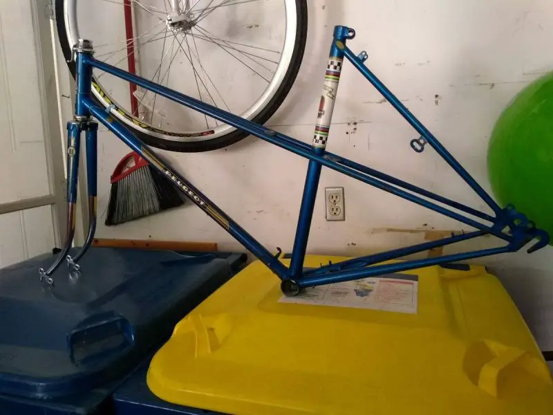

I’ve seen someone get a regular HT engine in a mixtie but will one of those “Bullet Train” electric start engines fit? I’ve attached the frame in question.

I picked up the frame today. The frame looks so pretty it almost seems a shame to chop it. Do you think I can put 24 inch wheels or even 20's on this. I would like to fit a fatter tire on it as these were built for skinny road tires.
Unfortunately, I think your questions can only be answered by trial and error. I have seen quite a few successful builds on the forum on step through frames.
-Changing wheels sizes from stock can make it tough to mount the right rim brakes. You may need to use a universal caliper brake mount if you change wheel sizes.

You're still going to have issues mounting these in frame engines inside the tiny space afforded by a mixte frame, plus the fuel tanks are made exclusively for men's frames with a single 1"~1.125" top tube. You're efforts would be better rewarded using a late 1980's MTB bike with good componentry.. If this is your first motorized bike build it's always best to just build up a standard framed bike to see if you even like how the engine works. These CG engines can occaisonally have tuning problems with carburetor and ignition timing, you need to fine tune the main jet and make sure the engine has the magneto rotor on the correct direction.

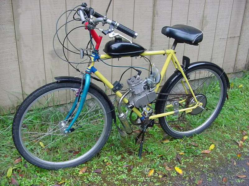

This is my 63 year old J.C. Higgins with a 48cc CG engine
