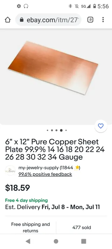

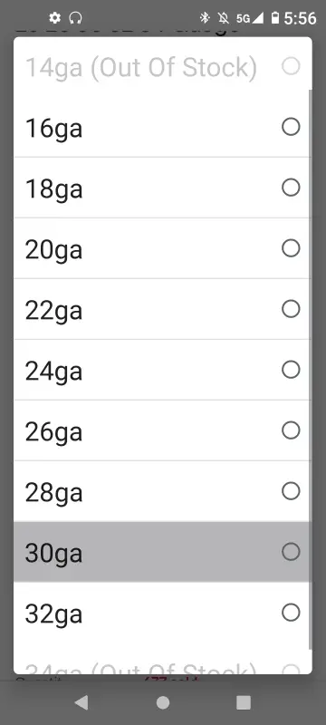

So I'll have to.... Aneal the copper to soften it correct if I cut one home made?
Yes heat it to red hot and let it cool slowly 3 times or you can buy it dead soft for a little more money
