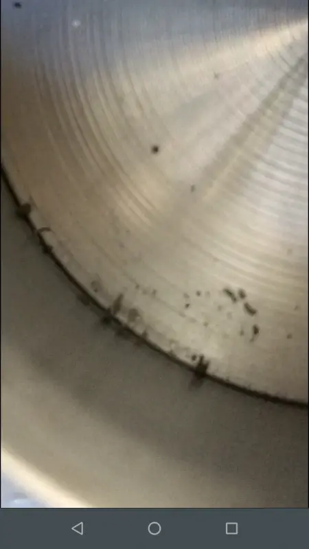

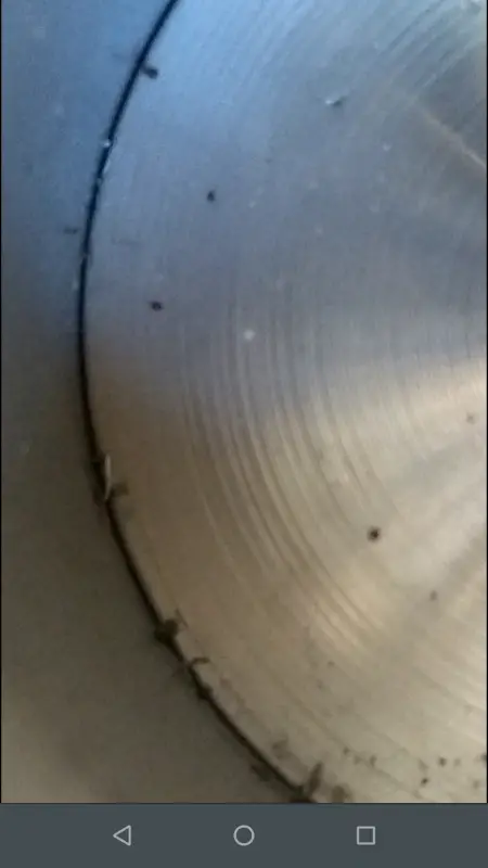

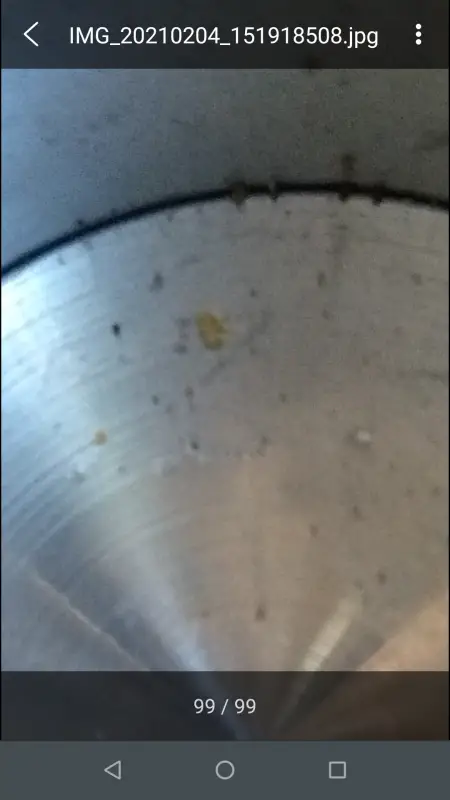

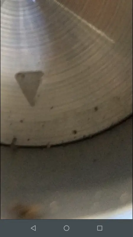

First, take the head off the piston cylinder cover or head and look down in the area where the Piston is at for debris and foreign material. I did this just on a whim to see what it looked like in there and there was a tremendous amount of metal shavings and things that I could not identify.. especially metal casting shavings from them tapping these spark plug hole and letting the debris fall inside.
Clean and wipe the cylinder and top of piston. Depress the clutch lever and move piston downward to expose anything that may have fallen between the cylinder wall and piston. Swab cylinder lightly with 2 stroke oil.
Check all ports,channels and flanges for casting "bugs" , places the casting may have bled through. Clean, sand or grind imperfections noting where your debris is falling. Place tape over the exhaust and air intake ports to keep them debris free.
