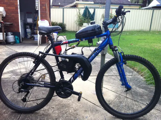

Hi all again,
Ive attached some pics of my magneto muncher.
Its a grubbee 70cc skyhawk with a 18mm mikuni and a dirtbike pipe with the usual top end mods.
Im now onto my 3rd magneto in less than 500kms.
I replaced the CDI aswell the 2nd time the magneto was replaced but sure enough another one went.
I usually ride the bike up in the top end of the rev range as it has a 44 tooth and the right setup for it.
Is the chinese magneto crapping out due to excessive high revving?
I wouldnt think so, as there is a fair few MB's getting around on here which have been modified further than mine, that dont seem to come across this prob too much.
There is no trace of oil in the magneto housing or whatever its called..
Has anyone worked out a fix or replacement for the ignition system yet that is proven to work better than the china sys.?

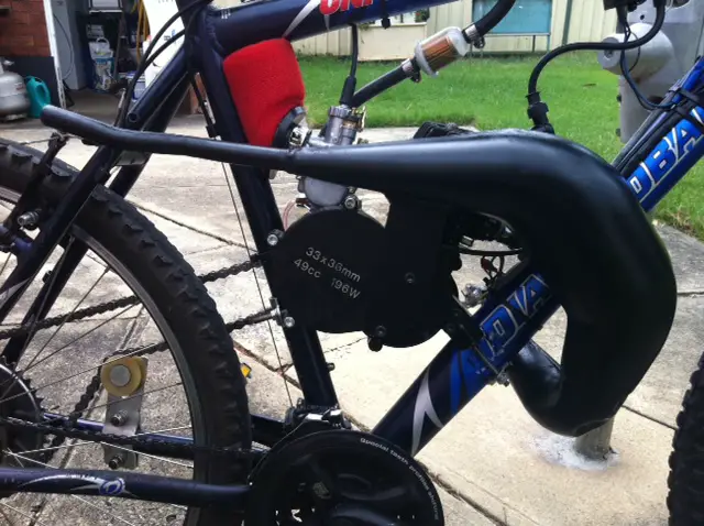

What are you doing with the white wire?
Just cut it off right at the Mag, you can kill the motor by just grounding the blue wire with the button.
cheeky bastard.... 196W... i need to do that on my kit. anything over 200w is illegal here.
haha thanx 196W is just a random but the bore and stroke is off a 49cc i think.
cost me 22bux from an industrial engraver here in syd.
KC the white wire just has a bp connector on it at the moment isolating it from the frame.
But yeah I think i'll cut it off anyway no need for it really.
I read somewhere on the grubee site that we are supposed to sand back the back side of the armature before fitting up a replacement magneto to get a better earth or something. Havent done that yet either so thats on the list too.
