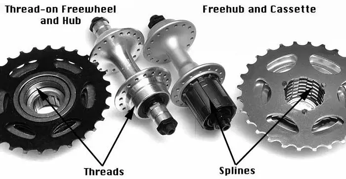

yes it really does 28mph with a 48v motor. the wheel is set up with a hyperglide free wheel mount for your gears. lots of bikes come stock with them. here is a link the magic pie is set up for the freewheel on the left
