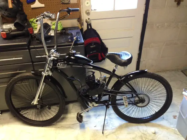

An engine will fit in the tight frame of a Micargi Falcon, so fitting the Rover frame shouldn't be a problem, IMHO.
Yea it will fit my micargi phantom, same frame geometry, had a 2 stroke before.
The guy who had it before me drilled trough the frame to install it, PLEASE don't do that to your bike!
Get the large downtube universal adapter or find the newer engines with the larger mounts.
Yea you still can, you might need to make or buy your own brackets that go all the way around the big top tube.
Or you can copy bikenut's idea and keep that top tube clean and clear, and make a dual fuel bottle setup behind the seat.
I might opt for that option later on for my micargy four stroke.

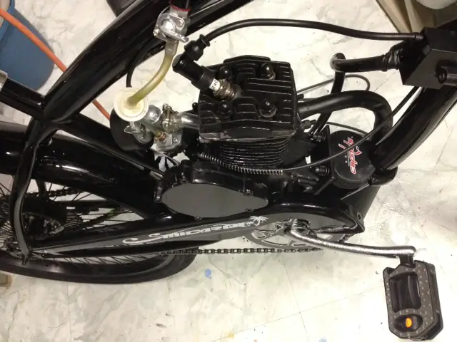

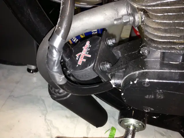

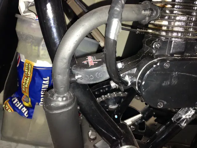

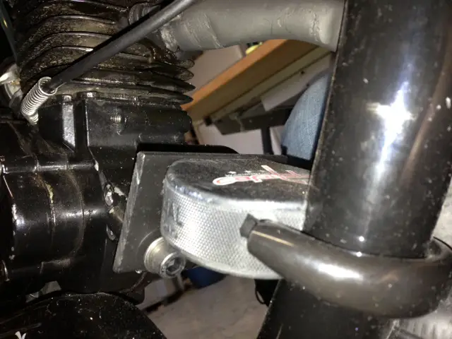

There is a lot of room in the Rover GT. As you can see I put a 2 stroke and also a 4 stroke engine in these bikes.

It is the T-post bracket. The one where you have to drill a hole in the steel frame. I drill the hole oversized and insert a steel tube inside then run the bolt thru it so when the bolt is tightened it will not crush the frame. Just one of the ways I do it. A lot of people on here have a fit if you drill a hole but I still say if you reenforce the hole as to where the bolt can`t crush the frame, then it should be okay. At least I have not had a single failure with the ones I have done that way.
The hockey puck mount is awesome! Being from Buffalo and a hockey guy I'm totally using that! Anyone know what sprocket kit fits the Nexus 3 speed? I have a Micargi Rover NX3 with 26 in rims. I think my bike and the GT frame are the same. I'm just starting out and I'm a Tech in the Army. I didn't want to start another thread if ours bikes are the same and clearance arethe same for the chain and mounts.
