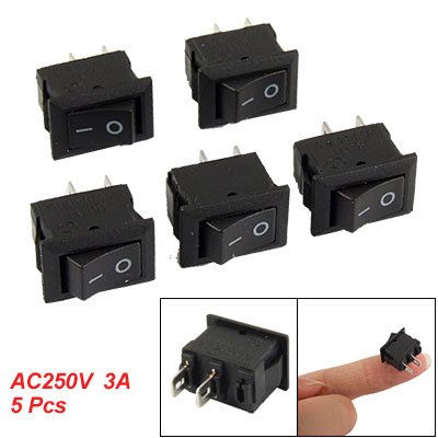

Yes, I read all about these kill switch issues before I even installed the kit. This site is great for providing such info. So what I did was to install a toggle switch on the blue wire (hot wire) between the magneto and coil. Right now I have the toggle switch zip tied to the handle bars in easy reach. But I have ordered mini boat rocker switches that I will be able to fit into the throttle housing where the kit kill switch is today. Then I'll be about to switch on and off the circuit without releasing the throttle grip.
Link to mini boat rocker switches small enough to custom fit

I am used to having a rocker style kill switch on my motorcycle so I prefer this style anyway. With a rocker switch, when it is in the "off" position, the engine will not run and I will leave it in the "off" position except when I want the engine to be running. I will be able to install the mini rocker switch in the throttle housing so all will be as it should be. :)
