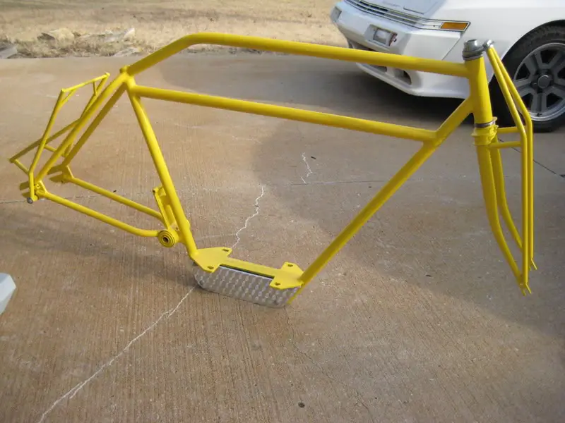

question...does anyone sell a lower tube shaped already for converting a worksman to a board tracker?
Not likely. In order to construct a frame with somewhat authentic dimensions, it needs to be stretched a few inches. This means extending or replacing all three tubes, not just the bottom tube.
Here's a crude comparison.

i see what you mean wret.......not a good idea id say. reason I asked was theres a new worksman here for sale and i was gonna buy it and try to sell the frame, figuring it may need that...maybe left unaltered is better.
Racie, you can "cheat" like I did on the Worksman frame. Yes, you have to extend the frame 5"-6", but for the loop section an early 1950's Schwinn girls bike will fit the bill. I picked one up for about $30, cut out the loop section and it fits the Worksman like it was made for it. I admit it isn't as neat looking as a custom drop loop frame, but much easier and cheaper if you don't have the ability to bend the tubing yourself. There is some info on my build that Silverbear helped me with in the thread" Worksman.EZM Stretch. It'll give you enough room for a 4-stroke if you wish to go that way. Hope it helps.

I also used a front down tube from a girls Schwinn (60's if I remember right) on a worksman frame, but without stretching the frame. The different shape to the downtube opened things up enough to make a big difference. Stock, the worksman frame is a tight fit for even a china girl engine. With the alteration fasteddy & I fit a 1934 Sachs 2 speed 98CC motorcycle engine into the frame.
