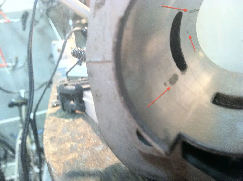

Well I took off my cylinder today. Ive been running a puch head and with an otherwise stock setup, needle bearing engine. I was a little disappointed with what I found. When I first got the engine it had a bunch of crap in the cylinder, metic shavings and such, so I cleaned them out. The piston had a bunch of little divits in it, same with the cylinder head mating surface. Anyway I probably have 200 miles on my engine now and I wanted to check out the cylinder. I was a little bummed out by the cylinder scoring but the rest of the engine look really good.

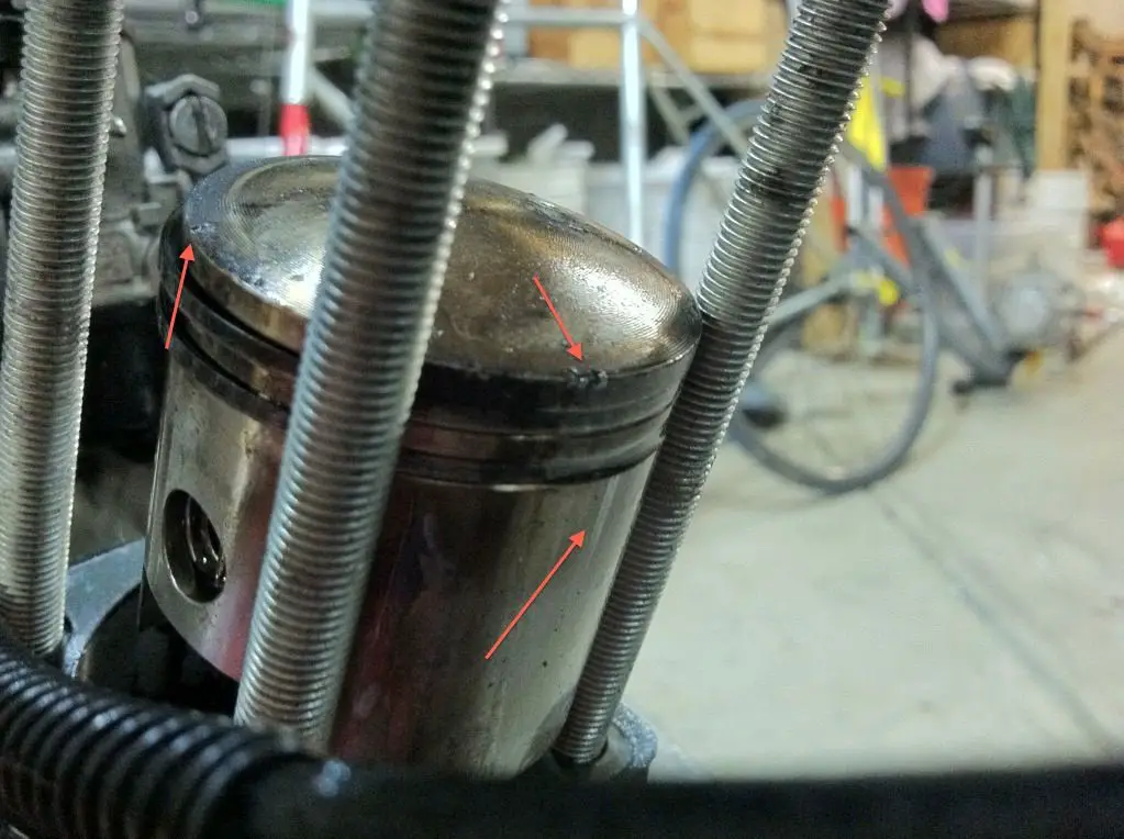

Here are some of the nicks of the edge of the piston: PS pics get big when you click them

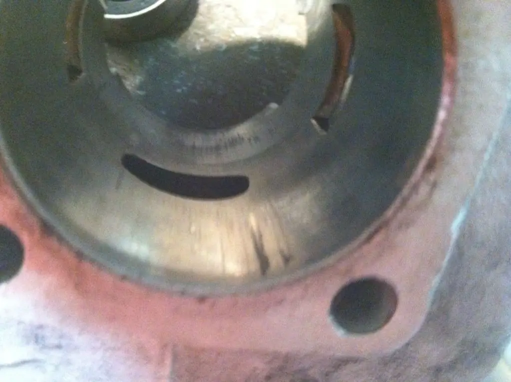

That part is not so bad, heres what Im worried about:

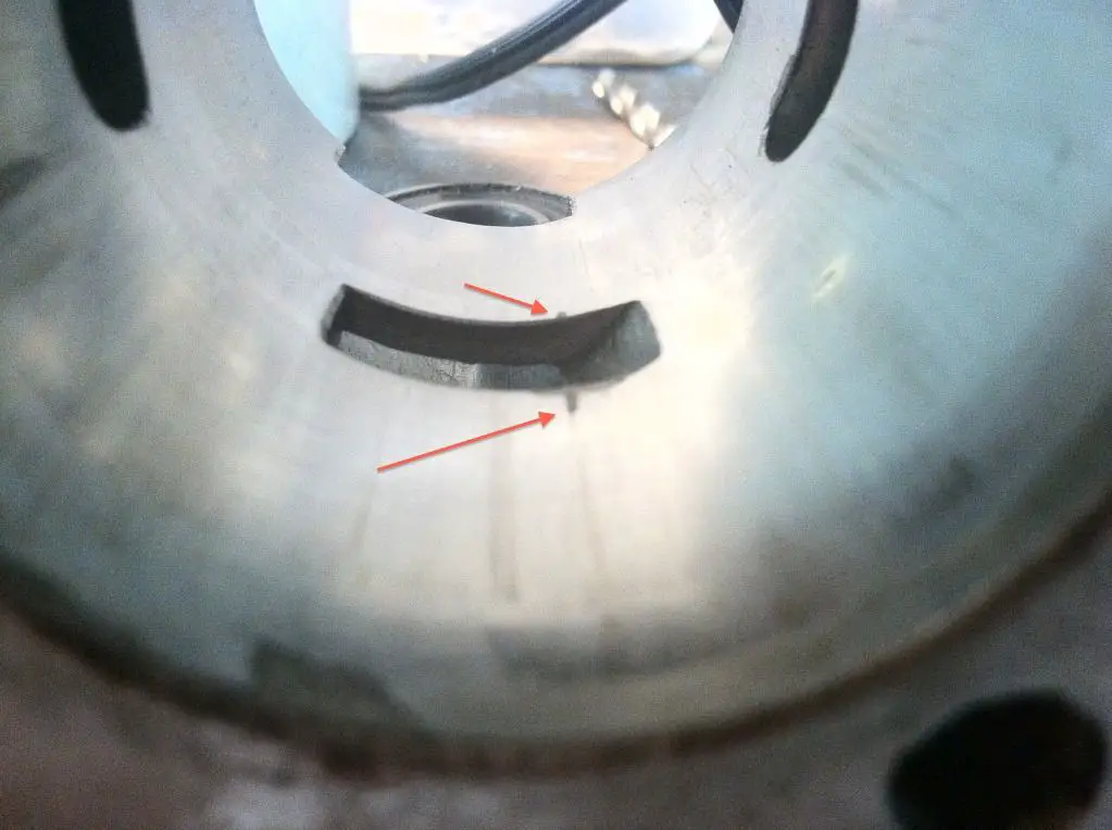

These scores come out a little more exaggerated in the pics, but I can definitely
feel them with my fingernail. So what do you guys think-new cylinder? Dont worry? Motodnut
Those scores look pretty deep, you could keep using the current piston and cylinder, probably won't be nearly as powerful as it would be, you could re bore the cylinder and get a new piston or you could probably just go the cheapest route and buy a new piston and cylinder or even a complete engine and keep the bottom end for parting out. it's up to you but I would personally just go for the new engine.
You can not "re-bore" these cylinders.
That looks like something got loose in there and made that damage. Is your piston alignment pin still in the piston?
If it runs, leave it alone for now, but that's pretty bad.
Thanks for the input, there was metal shavings and crap in the cylinder from manufacturing that made those markings on the piston, Im definitely getting a new cylinder. The needle bearing and wrist-pin are in really good condition, so nothing from that got into the cylinder. It still does 30mph. brnot

Chances are if you found debris in the cylinder you had more in the crank case that got drawn through the engine as you ran it. If and when you replace the piston and cylinder it might be a good idea to remove the crankcase and wash it out, we had to do that a lot when rebuilding engines for motocross bikes that were ran on as lean a mixture as possible.

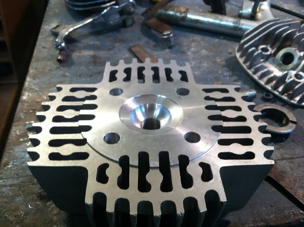

Here is the combustion chamber:
can you say niiice?!?!

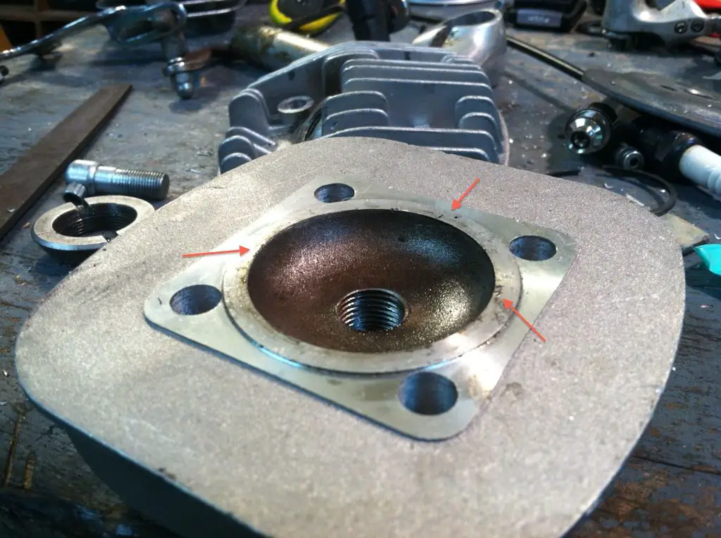

P.s here is the incredible P.O.S. low compression head that came with the kit with the same divits:
runs good! Not too worried but still gonna replace the cylinder.
i would replace the piston and also clean out the crank case since that's probably where it came from thats some bad damage. also what kind of power increase do you see from the head?
Moto, Thank you for the excellent pics, Thought maybe she got reeally hot at some point from detonation but your awesome head is pristine. Thats cool your still rolling, not to jinx you but you can replace your top when you smoke your bottom.LOL
