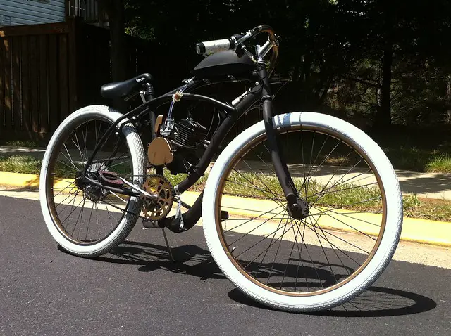

On mine, I actually used tennis racket grip. It's a bit thinner doesn't make the grip ridiculously huge. You can kinda see it in these pics.
Now, they're perfectly rattiie and worn in!

Yup. Good ol' cranny. Well, frame/bars at least. New fork, HD wheels, bearings and front V brake have been added since those pics.
If you have access to leather, I'd sew on a pair of grips. That's about as old school as you can get.
The seat post is made by Wolf's Den Garage...that's me! Used some random bits and pieces found at Home Depot.

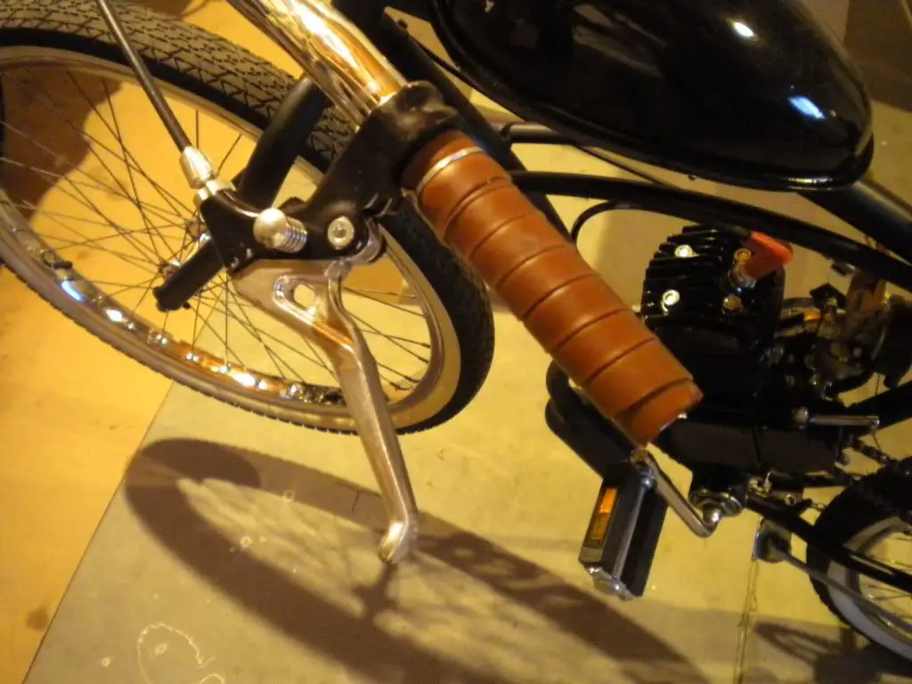

Here is the pic of my grips that I wrapped in leather, I'm still waiting for some new bar end plugs to come in the mail to finish them off.
Just cut the leather to 1 inch wide strips and sprayed them with contact cement, sprayed the bars also and applied. Finished off with some thin wire so they would not unravel.
