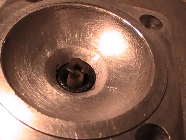

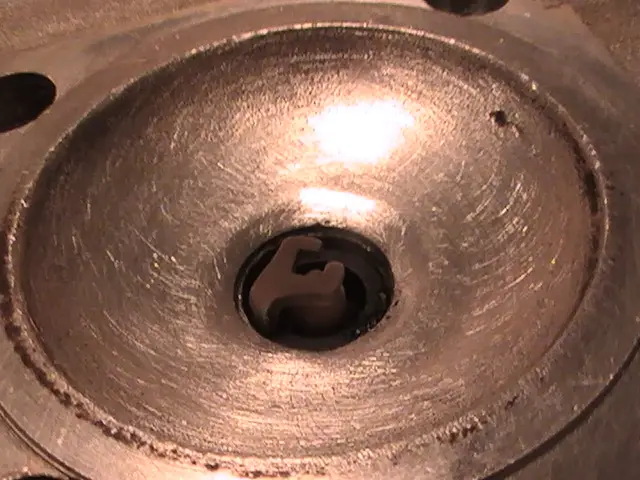

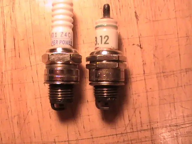

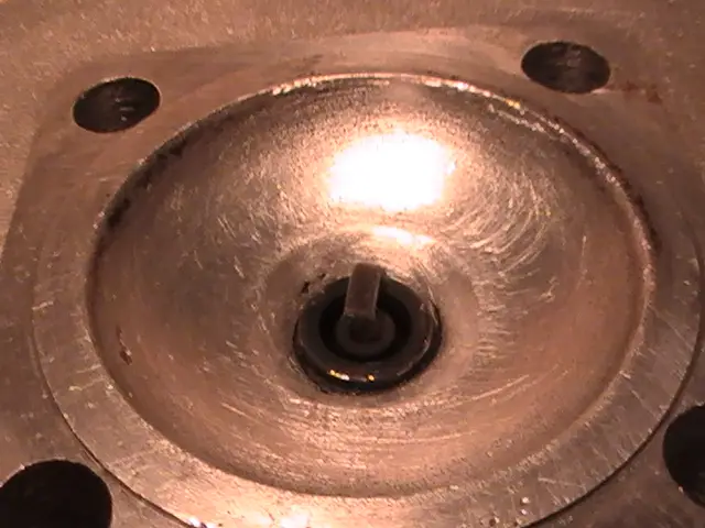

I noticed the plugs that I have did not reach the bottom of head when screwed in.
Just a thought. My bike and lawnmower plug little different.
After a bit of work, stock bike plug now sticking out of the head a little.
Here I needed to work some more to get lawn mower plug to do that.
Ok before I go any further. I ran with both plugs in this head before and after the work was done. With the stock head there was a five mph difference with allot of break up with the lawn mower plug before work. Do to that plug tucked up in the head I think? Not a tech here just tinkering around.
With the head work done, running two stock plugs and two baby lawn mower plugs. There is no change in running that I can tell, mph stayed the same no break up on any of them.
With. all that said, head work is not finished!That was just a test now that it worked I will go further. The pocket will be larger when finished and on a sertin angle where fuel will be distrubited correctly in the head. Allot cleaner but sand blasted when complete for fuel suspention. No spell check please see ya.
