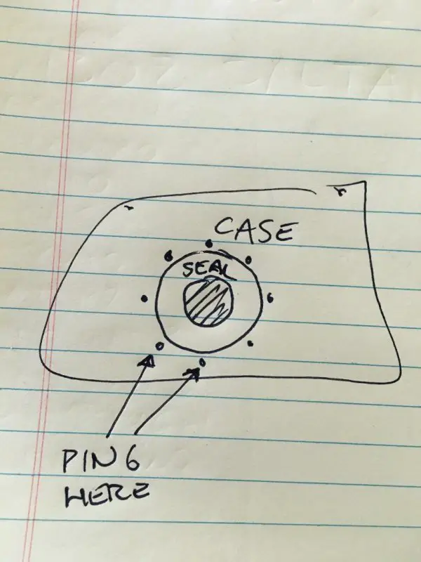

Seals shouldn't pop out too easy... But if you're sure you're installing them correctly & still having the problem?...
You can take a center punch & GENTLY dimple the case edge around the seal to flare the case edge a little to hold the seal in better.
DON'T GO CRAZY THO!!!!
Make each 'ping' about 1/16" away from the seals edge so the metal flares out a hair... & like I said... GO EASY so you don't break off a piece of the case!!!
