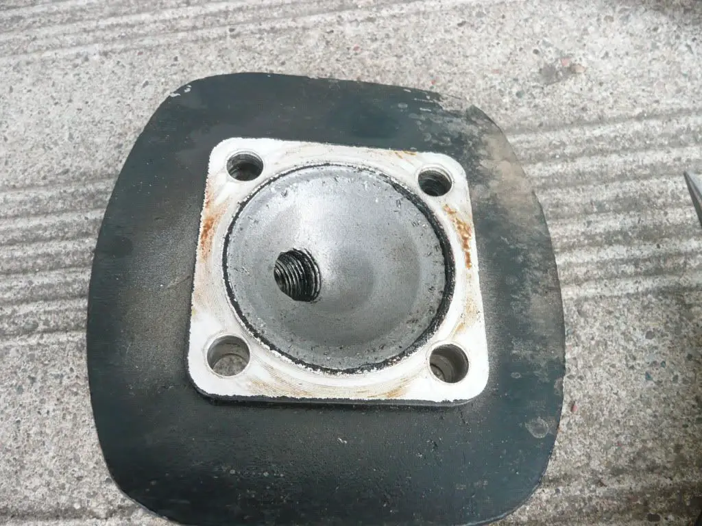

If a picture is worth 1000 words, here's 7000 words to describe my situation. I have taken off the engine head, and taken pictures of the guts. I also took some pictures of the magneto and spark plug.
Please take a look at the magneto images and let me know if you still think there's a leak there.
Without further delay, here are some images.

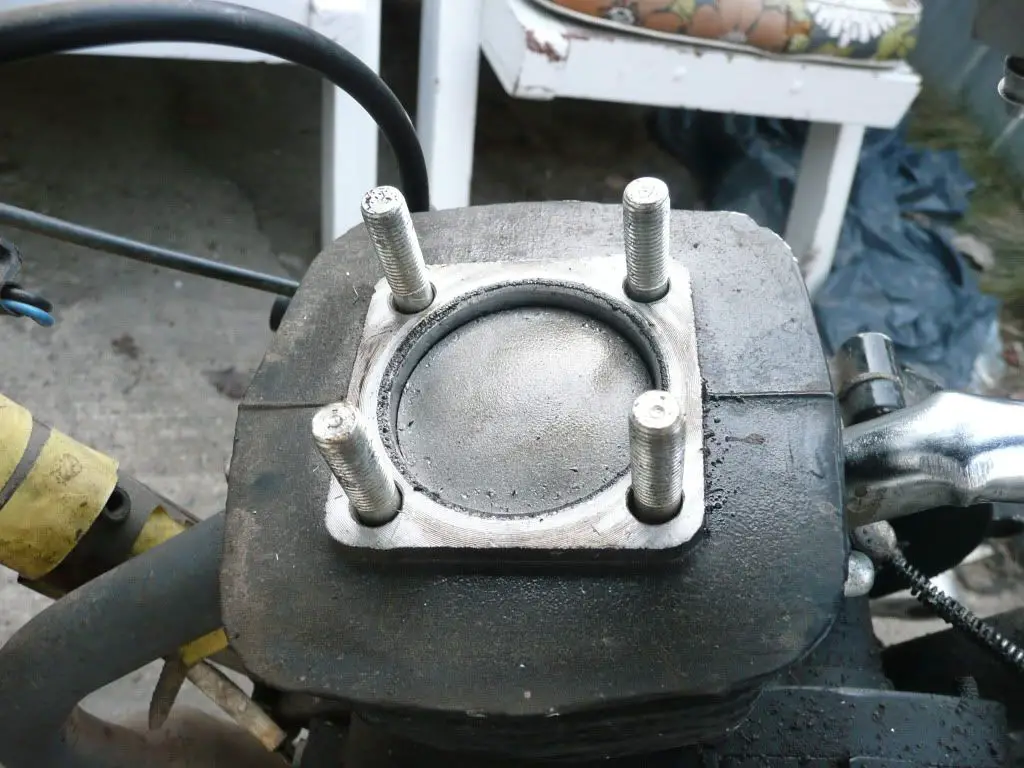

Piston head in up position.

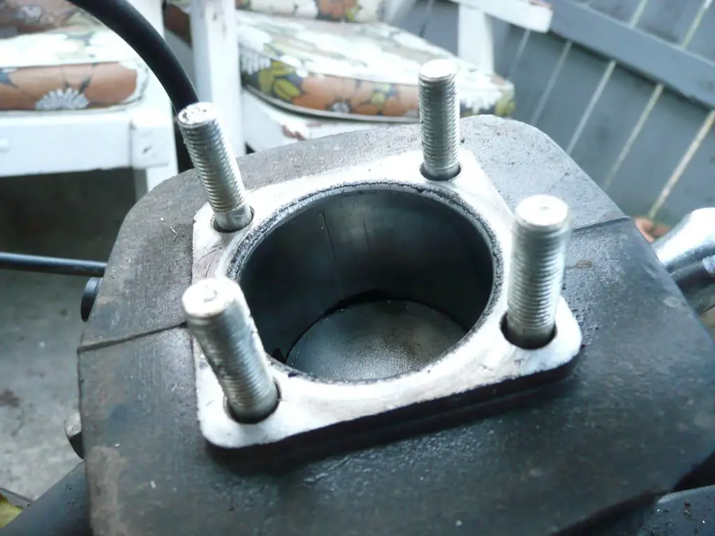

Piston head in down position. I see an injury here, is this cause for alarm?

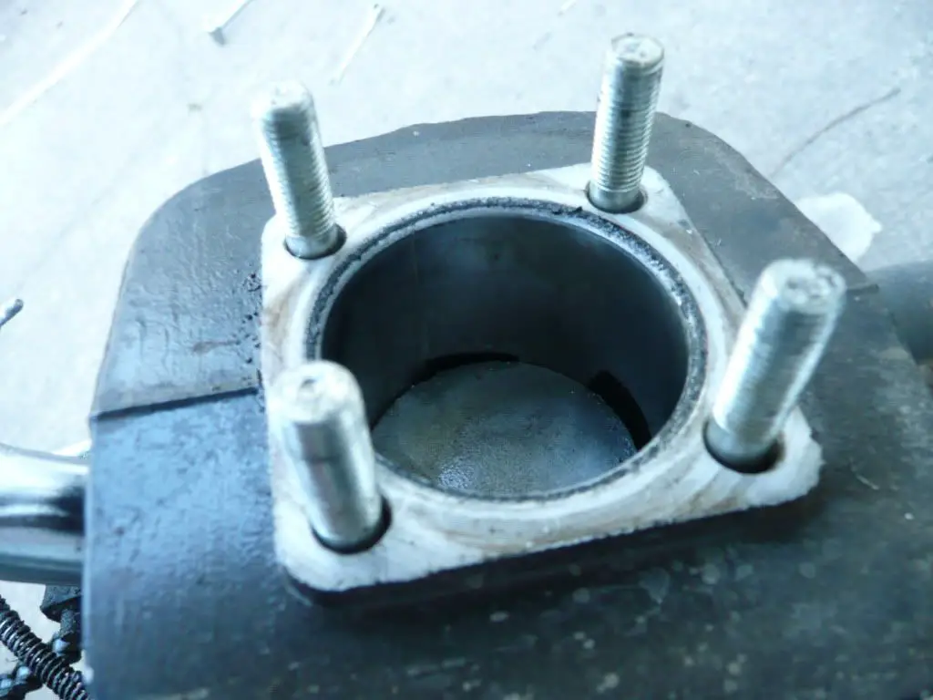

Same thing from the other side. A similar injury on this side too.

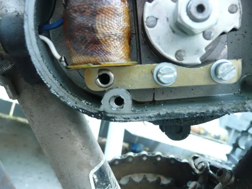

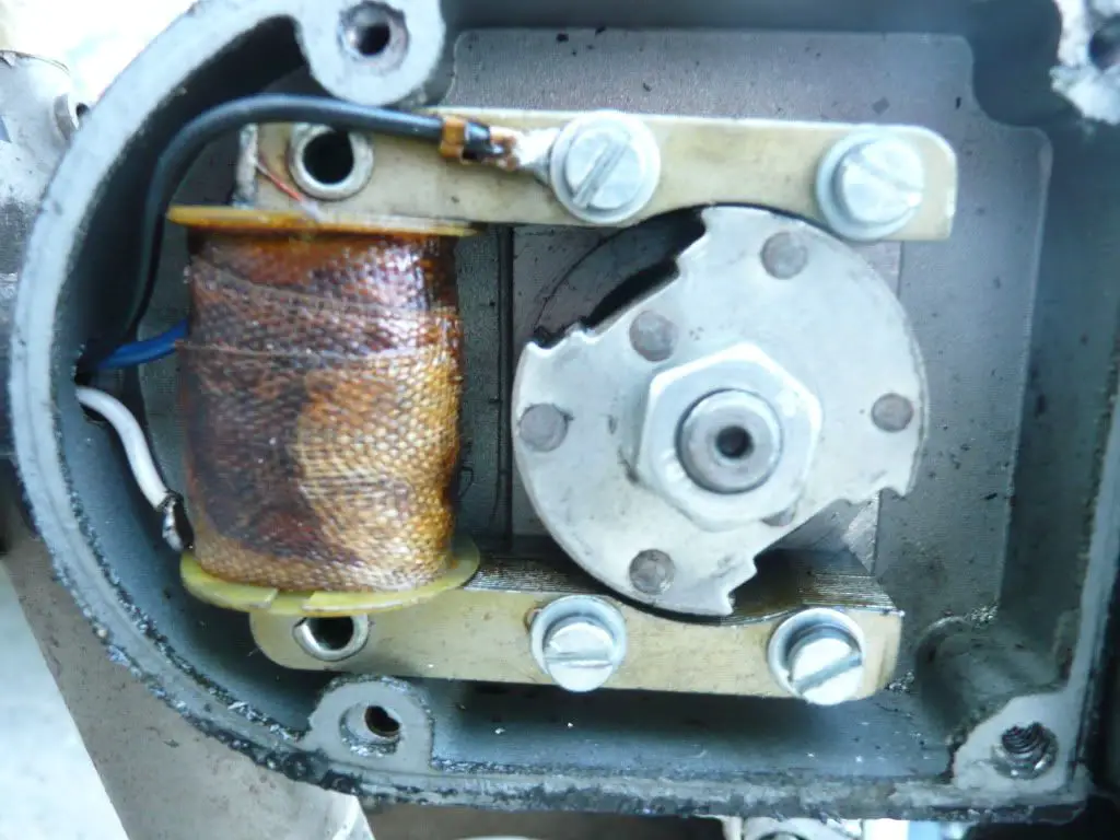

Magneto
My crappy attempt to show below the magneto.

Piston head cover. Nothing strange here.

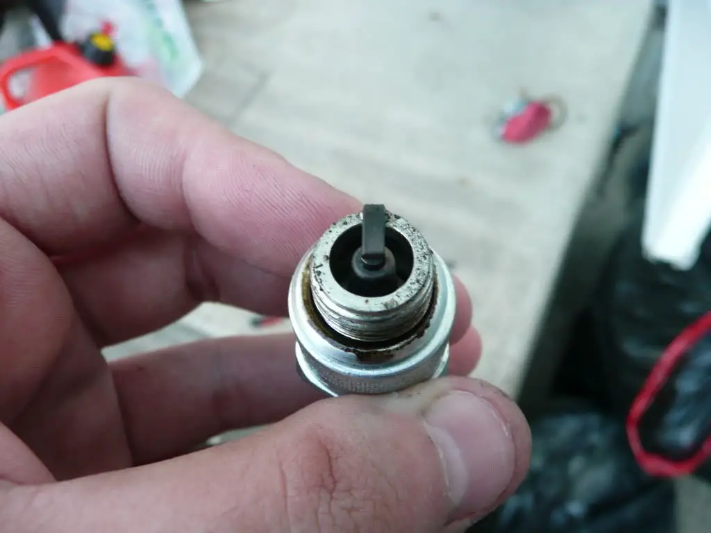

The spark plug. Is this a good color for a healthy fuel mixture, or is this getting fouled? Note this spark plug was brand new yesterday and has been run no more than 5 mins. I notice its more brown on one side than the other.....
Let me know what you guys think of these. I'm still pointing fingers at the exhaust pipe or carb. Perhaps I can take some pictures of the carb also tomorrow.

That scratch in the cylinder wall doesn't look good. There are several causes of that type of damage. Either a broken piston ring, a piece of garbage that was left in from the factory or something that was injested by the engine.
A scar in the wall can cause a loss of compression which isn't a good thing on a single cylinder engine.
From the photo it doesn't appear that you have an appreciable amount of oil in the magneto cover. I'd probably rule out a crankshaft seal at this time. I'm more concerned with the cylinder wall damage.
I took the liberty of enhancing that one photo so others might have a chance to comment on it.
Did you find/see anything that might have caused that scratch?

Well I hope I don't have a broken piston ring... I rolled the bike along a little bit without the carb on, and it feels good for compression. It sounds OK, and puts up about the same amount of resistance it did before. I'm no expert, but I'd like think this damage isn't the direct cause of the current problems. I guess it depends on how much of a difference damage like this can make..... What I do like about this theory however is that it supports the sudden appearance of the problems.
I do find it odd that similar damage occurs on opposite sides.... Makes me wonder if a piston ring might have hopped up at an angle or something scraping opposing sides.... Perhaps if this did happen the added friction (metal on metal) could be the cause of the extra heat I am seeing. I was able to easily move the piston with my finger however, and it felt smooth. I'm not so sure.
