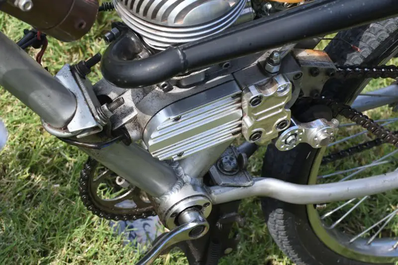

James I went to the Gas bike site & looked at the Gt 4 setup and they don't give much in the way of information about what they sell. All the GT this & that model numbers are confusing so since my crystal ball isn't working I'm guessing here. Gt 4 motor kit they claim 3.5 hp for (I don't believe it), that's without the reed and carb kit which you have (Keihin carb and 4 reed box valve) as I said in the previous post the reed and valve won't increase horsepower by themselves, but you should be able to get the motor to run ok with them in place when you get every thing installed correctly and the leaks sealed (if you have any) and the carb adjusted. I don't have any experience with the Keihin carb, but it should work ok with your basically stock engine. It's just not going to make any noticeable increase in power over a stock carb. The motor should run ok at least and I didn't make that clear in my first post; that is if everything works correctly and that's where trouble shooting comes in if the engine starts it's getting both spark and fuel/air mix, from there it's figuring out what's amiss. As I said the reed valve can cause initial startup and tuning problems because the reeds are very stiff when new and require break in first before fine tuning the carb. Once you get the motor running and can keep it running live with it for a few rides without expending a lot of time messing with the carb, after a few hours of riding the reeds should relax and start working.

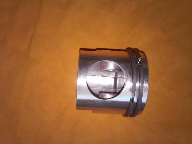

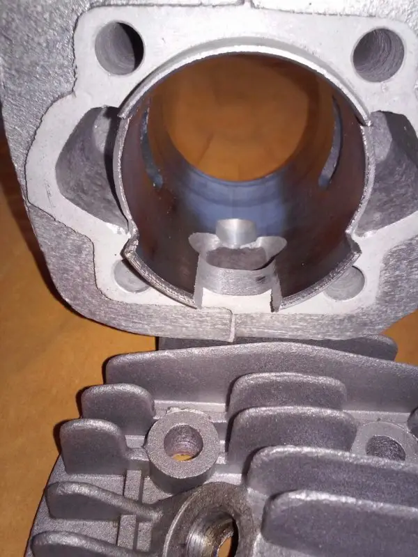

James I looked at parts that Gas bike has available and they do offer both a 3rd. port cylinder and a "window" piston (they call it a ported piston I believe) for the engine setup yo have. One or the other will allow the reed valve to work...both even better. The piston is $25. I'm adding photos of my own setup that I machined so you will recognize when you look at Gas bikes performance cylinder parts. I use a much larger round window in my piston than they do (small square window) but I'd think both would make power with your reed setup, but first get what you've got at least running!
Rick C

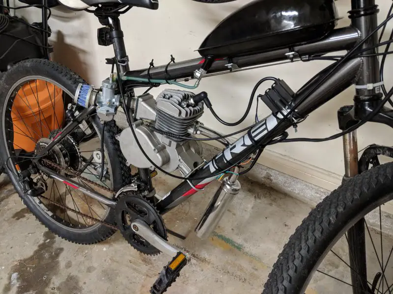

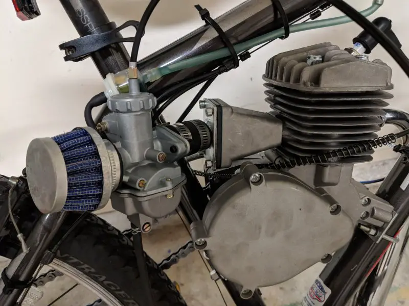

I have visually checked spark and it is good so you are correct that the engine is getting both components needed to start. When I say the throttle has no effect what I mean is on twist it impacts the engine in no way whatsoever. The twist is also very short compared to my other bicycle. As for the choke it appears to be working because when set correctly it does allow for the starting of the engine. However I have not been able to maintain a running engine so I'm not entirely sure. I will attempt to find air leaks as it is very possible I botched a gasket install or under tightened a component. I may go with kit carb just as I lack the expertise and honestly funding right now to pay for more components. I also am doubtful it makes 3.5 HP but a man can dream I guess. Thanks for the consideration thus far. I will attach a photo soon of the setup I am running. It was a tight fit on this bike so if you have any placement suggestions I am open. Thanks.
I figured I would start with broad photos, in the event I have done something obviously wrong. Such as Installed something backwards or just blatantly incorrectly. I can take more specific photos on request.

James I just took a look at your second photo & see what looks like a super long carb cable drooped temporarily (I hope) between carb and throttle and that's not good, and may be the cause of at least the lack of any throttle response. Cable should run shortest path along the straddle tube and then across the handle bar with just enough room to prevent binding when turning the bars, More on that latter, first take the air cleaner off and look through the carb as you operate the throttle to see if the "slide opens and closes properly with the throttle. do this with the droopy cable as is. If the slide doesn't function, fix your cable problem first. Then you may consider the following as well you may have installed the throttle cable wrong either inside the carb or at the throttle end or the lead ball pulled out or off the cable end ( either end). Kit throttles nylon or plastic guts often break or the lead cable barrel pulls out of the plastic, maybe installed wrong, lots of possibilities here, and in the end you have no throttle. If you see that the cable is lifting the carb slide and the spring is closing the carb slide with the throttle then try running with air cleaner off the carb. If still no go the reed valves may not be opening past idle or be hanging at the cylinder intake port. That can be a problem with the RSE type reeds but I've never been inside the Gas bike /Zeta style that your motor came with. Right now the lack of any throttle response at all is definitely a problem in my mind and your not thinking it feels right (short twist) in operation compared to your other bike build is re-enforcing my doubts about throttle to carb operation is hincky. I'll mention that the outside sheath of any cable should not move at all NOT ANY movement of the plastic sheath only the wire cable inside the sheath moves. If the cable sheath moves the carb won't function correctly. You can use cable ties at a couple of places along it's length to stop any movement. This is true with clutch cables, shifter cables and brake cables as well.
Your bike looks really great with the motor mounted.

Just took the air filter off and this is what I saw when twisting the throttle.
No visible effect that I could see. I went ahead and tested it with the filter off and it operated as it has every time I have tested it so no surprises there. I'm gonna work on straightening out the cable, and then investigating if I installed it into the carb correctly and I will get back to you.
Yes James good camera work...that slide doesn't open at all so the problem lies somewhere betwixt the throttle and carb and perhaps two or three problems including your shortcut mega cable hookup!
Incorrect cable routing inside the carb is common with Mikuni carb and the Kehin may be similar in that regard. Spring and cable shouldn't bind inside.
