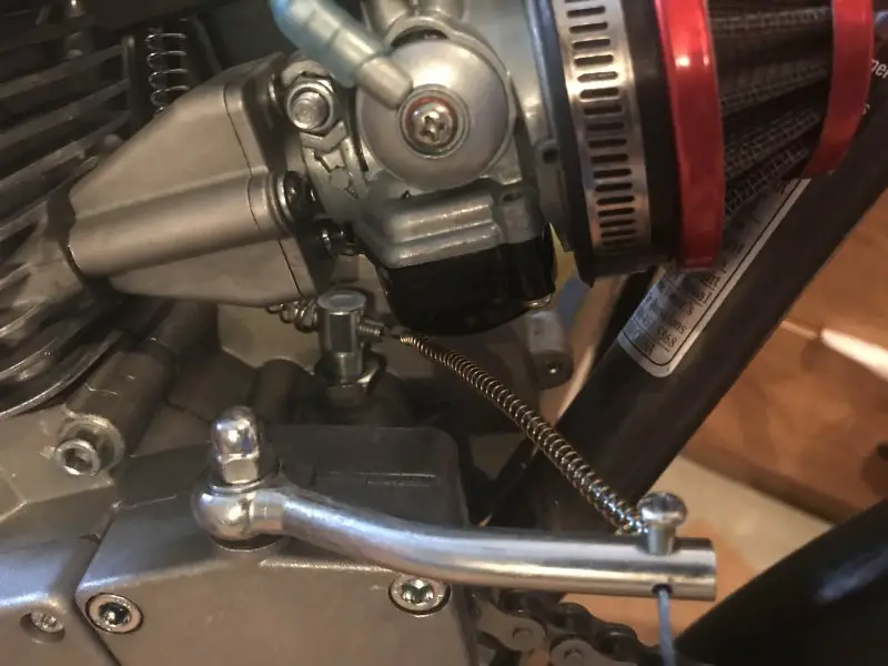

I got a high performance carb.
That's an HT carb, is it brand new or was it working and then stopped? Also, do you also have a reed valve? I can't tell from the picture
Yeah, the carb is new and the bike only runs if fuel is added manually to the chamber and when throttle is pulled the engine revs, so I assume the carb is working, but the bike does after 30 seconds
