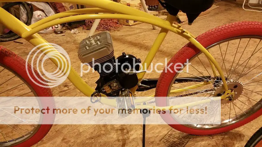

Jug deck on newest engine build
Well I mean look at the fin work on it! Looks all uniform and good!
Yep like Dave said, you can get the same results with the right paint and a little practice, I painted the entire bike with rattle can, the frame is a spray equipment enamel from tractor supple and then several coats of a clear enamel made by Valspar which is an excellent clear coat, best Ive seen for a single system rattle can clear, only thing better is the stuff that is a two part clear in a can because it has a hardener that can be released into the mix, Dave is the one who turned me on to it.
Even the chrome wheels have a couple coats of the Valspar clear to help prevent rust since the chrome wheels we get now days have very thin chrome plating.
I clean all my engine pqrts with either CRC brake cleaner or the cheapo Johnson carb cleaner I buy at big lots discount store here for $1.80 per can, let it dry good avoid finger prints, get parts in area where you have good lighting and start with light coats, let it dry 30 minutes in between coats in warm weather and you can end up with a nice looking paint job.
Just be patient and take your time.
Yes it is... and you can most likely do just as well... just do the surface prep and use good paint... it's really not hard to paint an engine. it's all in the prep and masking work that'll give you those type results, that and spraying it on with several thin coats vs one or 2 thick coats... Most these paints have those fan nozzles on the spray head that'll make it even easier to get pro like results at home.
Just get a can of engine paint and try it out on a used or scrap jug, you'll see how easy it can be.

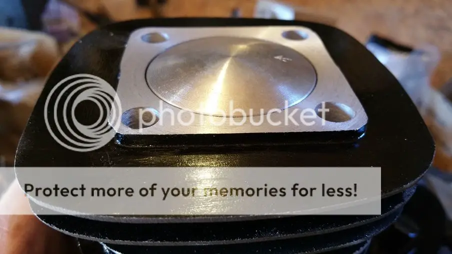

Here is what the Jake Head looks like, combustion chamber is similar to other after market heads but the squish area is where they're different.
I'm not saying its a better design, since I dont know it the difference will actually improve combustion or hinder it compared to the Fred Head and some similar heads we have to choose from nowadays.
Just wanted to share some pics of the head and show how three different head gaskets I have will look when place in position around the squish ring area which is where they sit rather than just flat on the head.
I must make a correction here also, I had said that the squish ring will actually sit down in the bore with a thin gasket, although this is true that it will sit slightly into bore, it is limited to how far it can do this because after taking a good measurement of the squish ring its actually 48mm in Diameter and if you remove the gasket completely the squish ring wont go down in the 47mm bore, I ordered head in the post from MZmiami because I wanted to make a direct comparison to the one I got from Jake, there is little doubt in my mind that both of these heads are being made by the exact same manufacturer, it isn't a clone in my opinion, side by side every single detail in the machining matches perfectly...so anyway fro ahat thats worth I just thought Id tell that like I'm seeing it.
And NO I'm NOT..... saying that someone shouldn't by from Jake, I like Jake personally and I will still buy parts from him in the future.
Some people can afford a $80 head and others can afford a $45 head, MZMiami like this vendor or not is offering people good parts, good service, very quick FREE shipping at a very good price.
Fred is selling the 6cc Fred Head for $45 last I looked which is also a darn good deal and Fred is a good fella, so that is always a good option also.
Just don't want anyone here to think I'm not supportive of our local vendors because I am.

Remaining pix of gaskets actually on the head so all can see how each thickness matches or reveals more of the squish area, this head came from MZ with the 0.040 gasket, and I had the others from other vendors.
Cylinder deck height is gonna be more critical with this head design, I put the Jake Head on my Taffy bike engine and I almost shaved the deck to much for the gasket I used since I have a squish clearance of less than 1/3 of a MM, I may have to add an extra thin base gasket or a slighly thicker head gasket if compression is simply to high or if the piston were to slightly tic the head once engine heats up and things expand.
