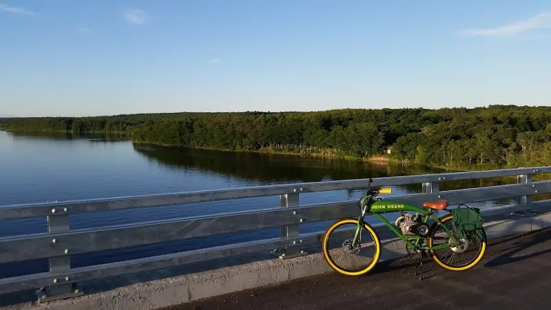

JD Themed GT2A-S, 4 stroke
Finally getting back to doing some work to my bike. Changed the saddle a while back and added a layback post from sportscarpat with a 25.2 to 27.2mm shim. This weekend I did the AGK airbox mod to the stock box. I bought a sheet of UNI fine foam, something like $11 shipped from Amazon, the black square is my stock filter, so this is enough for roughly a gazillion filters.
