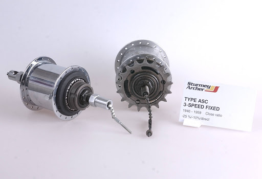

Actually Cannoball2 has adapted Sturmey-Archer's 'fixie' geared 3 speed hub to use with the output of the CG engine. I'm surprized a few of you old timers here didn't read his conversion and test ride of this hub.
It's an expensive gear hub, nearly $150 bucks new. But tough enough to handle your engine's power from a stock 66 cc engine. And it gives you three forward speeds from the engine side, and allows you to pedal start your engine as the hub is 'fixed' gears and doesn't freewheel.

Thanks, here's the hub.
yeah you want the aluminum shell version as CB2 drilled it to fit up (bolt..) {Edited to correct the sprocket maker...} Sturmey Archer 8 speed IHG sprockets onto the outside of the drive side spoke flange. Basically setting up a hubgear jackshaft. It's pretty brlliant work CB2 is a really creative guy and he shares his work. I'm using a Yamaha PW50 clone carb on my 48cc CG engine after reading his experiences with these clone carbs. It's a brilliant carb for the small engines.
