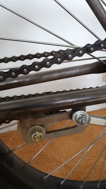

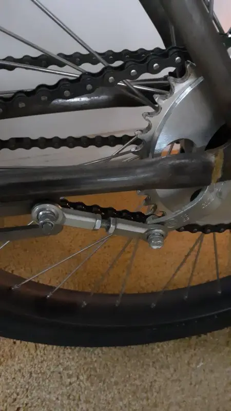

The photo shows a really strong brake connection setup I used on one build.
Now the question of disabling the coaster hub. This has really stirred up a lot of discussion over the years. The hard way is shown on Youtube by several people & the ones I watched will work. Not a quick job. The easy way is to remove the frame bracket and brake lever and reinstall the wheel, no brakes so you are then faced with installing disc brakes on the rear which can be a daunting experience first time around. If you want disc brake on the rear a new wheel, set up for a rotor, is a good option.
To indian22: what kind of bracket is that that the other two pieces connect to? I like that setup and willing to try it on my cruzier. Thanks! I'll post a pic of how mine looks right now a bit later so you have a visual.

That's a slotted plate welded to the frame. It allows the chain to be tensioned and provides a secure spot to attach the brake lever arm. The connection can be as simple as a short piece of steel, drilled at each end, to attach the bracket. I used two small heim joints and all thread to attach , the lever to the bracket which works well and looks neat but really over kill.
Rick C.
