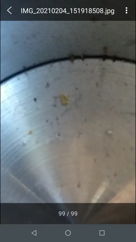

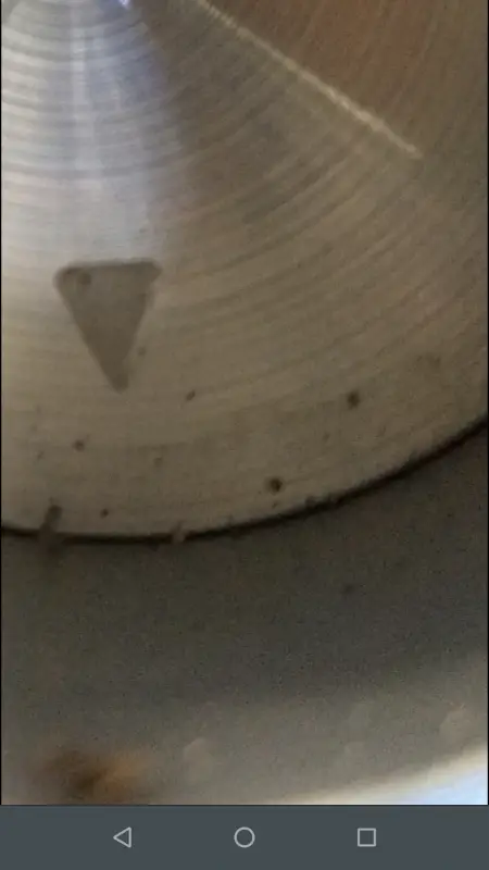

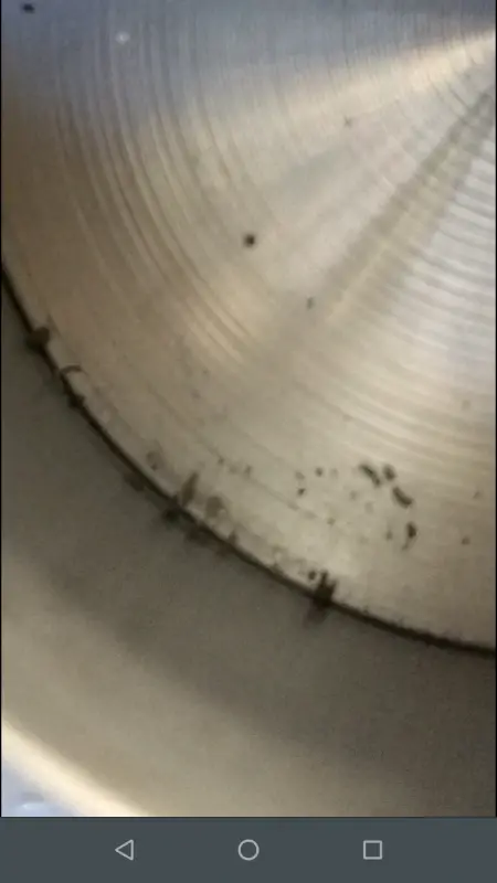

Hey guys it is a good idea to take the top of the cylinder off and check the inside of the cylinder for debris. I bought an anbull 80cc and I kept having this nagging feeling that I should check it and I did and I'm lucky that I did because there was all sorts of metal shavings in it from them either tapping the spark plug hole or cleaning it up. Check my photos . Before clean out. I used duct tape turned inside out on itself to remove the particles.
it's a new motor it should not hurt the gaskets at all to remove all of the cover plates and inspect the magneto area the crank area and clutch. I also found clutch Pad debris in the the clutch compartment. it's a good idea to just go over the whole engine entirely and check everything.

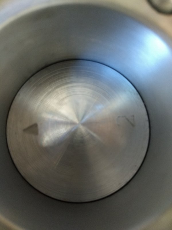

Pistons come installed backwards too
BTW the S/P hole is drilled and tapped while the head is off the engine
any metal filings ya found on top of the piston probably came from dirty factory conditions while they were slapping the engine together
Instead of duct tape use a vacuum
