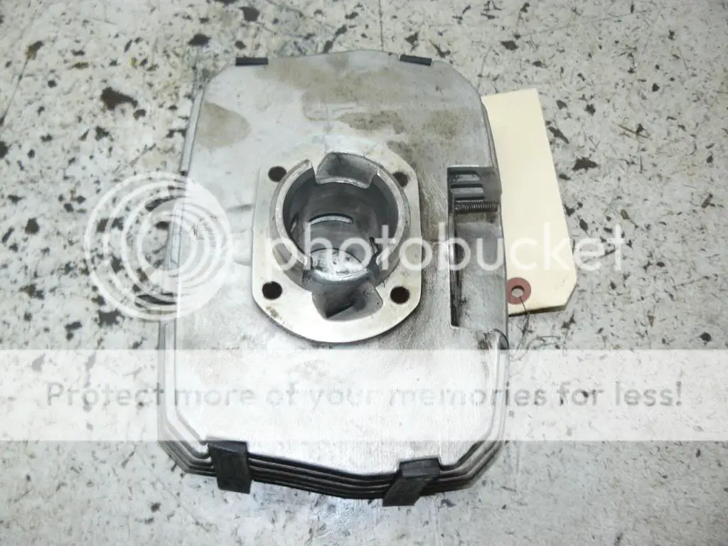

I think that is a non reed valve motor dunno? Here is what the combustion chamber looks like? 1998 LEM 50 FRANCO MORINI S5N MOTOR CYLINDER HEAD | eBay

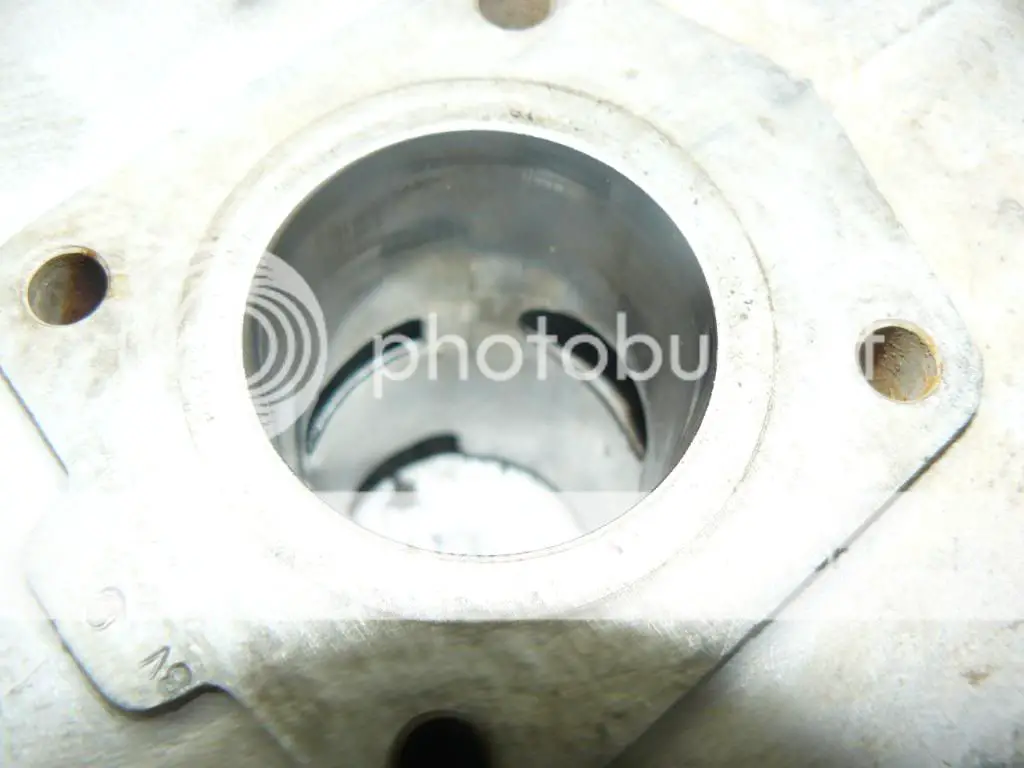

I think this is what the bore looks like? With this Kind of air cooling its built to rev!
