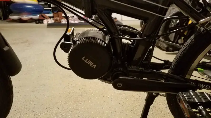

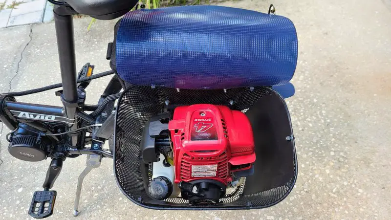

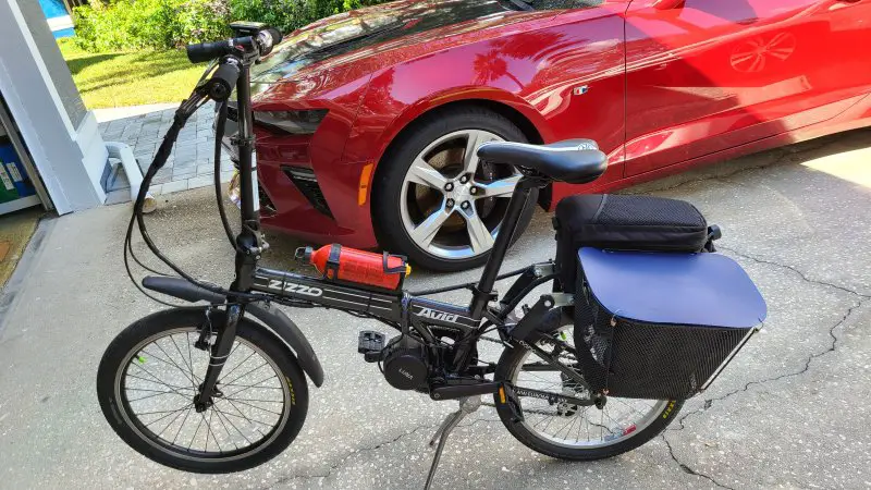

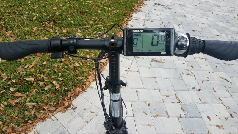

Here's an electric BBS02 mid drive kit, combined with a Honda 35cc Staton friction drive, on a 20" folder.

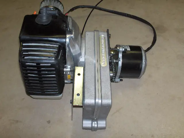

In the event you wanted to do a rear rack mount Staton Inc makes a hybrid gear box. The main purpose of the electric motor is to assist the gas engine.
