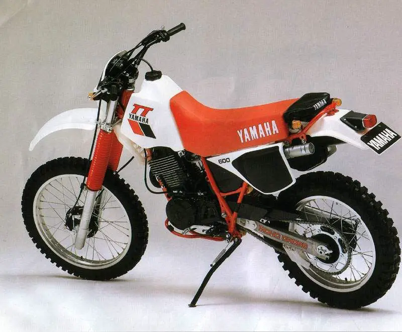

I had an XT600 that I bought brand new in 1985.
Rode it 1 year, which was the warrantee period when it started shutting down for no reason. Would shut down for a couple seconds, then start back up. It got worse with time.
It got so bad that as I gunned it out into traffic it would quit and toss me over the handle bars, and THEN it fire back up flinging me back on the seat! Not safe at all.
The dealer was good about it. It rarely ever happened at the dealership. They only charged me for the parts tried and minimal labour for what would be servicing anyway.
Finally they found it. Protective varnish coating inside the steel gas tank was breaking down causing almost invisible scales that would block off the petcock filter. Shut the gas off or shake the tank and the fuel would flow again. They pulled the petcock filter and installed an inline filter.
(stock photo identical bike)
