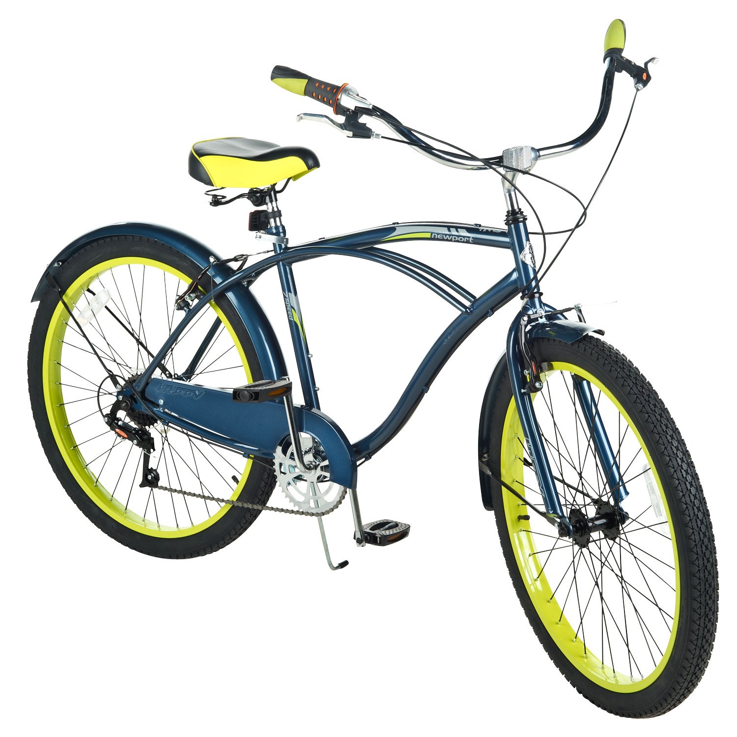

Anyone have any thoughts on the huffy newport? I'm considering using this as a "Low-end" cruiser for customers. I haven't seen any threads about the huffy newport so I guess I'd just like to know what you guys think. Also, I'd like to know if you guys see problems with the seven gears in the back staying there. Currently the shifter is on the right side so it would not be a good idea to keep it there I'd imagine. Is it possible to just flip it over and use the shifter o the left side of the handlebars?
the main reason I want to use it as a "cheap" version is because it already comes with front and rear brake + fenders (those are important for rain days) Plus the white version would look sexi!!! I would make one of biknuts fuel tanks but white or black for contrast (or green in the one case)
Opinions? Foreseen difficulties? I'm already well awayre of some of the crappier welds on some of these huffies, but no worries I used to work in the aerospace industry and I can tell when a weld is solid or not.
Thanks for any info!!

You can put a gear shifter anywhere it will fit. After that just make sure the rims are steel and the spokes are at least 12 guage.
I've been riding a Huffy Cranbrook cruiser for almost 2 years now. Huffy was starting to get a bad name for making too cheap bikes. I think it was 2010 when they started dolng the better welds, steel rims and 12 guage spokes. I wouldn't trust 14 guage (or smaller) spokes at 35mph.
fatdaddy.
Don't try using the stock fender mounts. They will fail and you can get seriously hurt.
Remove or reinforce them.
Other than that, these bikes are good budget builds. They look and ride nice.
The thumb shifters are easy to place where needed.
I really like the looks of the black and white Huffy! Those would be the great start for budget 'shifter' bikes.....
allright, that's a good point on the fender concerns I don't wanna make 400$ catapults. Thanks for the input, really. 12/14G spokes though I'm going to walmart right now to check on that. I really don't know how to tell the difference. I'll get some pic's while I'm there and get em back here.
I was gonna mention the fenders, Then forgot. The stock fender "TABS" will kill you. They are cheap little things that will break and leave your front fender UNDER your front tire. I've been calling this a "front fender ski trip". Trust me, It's not a ski trip you want to take. So listen to maniac on this one and either remove the fender or make new brackets out of real steel.

That Newport looks like a good bike for the job.
I bought a Cranbrook to motorize after taking one look at those 12 ga spokes. They haven't let me down yet. It's been a good bike for the job.
And don't forget the good old stem mounted shifters. Not too hard to find. And they work very well for this job. On an older motorized bicycle of mine I used one shifter for the rear set of chain rings and the other for my choke. The best part was that I could use either hand for either job.
I also used a Cranbrook for my personal build. But with the Newport you already have a pedal chain tensioner, ( the derailleur.) so the chains on both sides would be a lot easier to set up. I like my axle set all the way back in the dropouts for max support. To do this I added a link to the pedal chain and stuck on an old derailleur I had laying around. That gave me enough to get the axle all the way back in the dropouts. The Newport is set up like a Mountain bike, (kinda,) so you wouldn't have this problem. Plus dual brakes!!!, Sounds like a win win to me.

I think the blue one is just a single speed.
That white and black one still speaks to me.......lol
It has 12 gauge spokes too, I found out from the huffy website. Only problem with the bike is that it isn't sold in any of the stores in my area, I have to order one online and have it shipped. That doesn't give me the opportunity to look over and inspect the welds before I actually buy it (I used to be FPI in the aerospace industry). It may not seem like a big deal to most but I've seen some huffies I could slide fishline through the pitting, and then there are some unsightly welds all around as well (the panama jack's welder sucked!! I have yet to find one with nice welds.)
