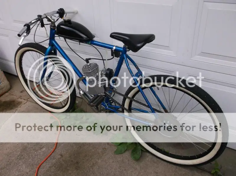

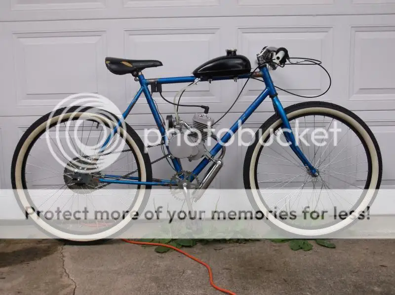

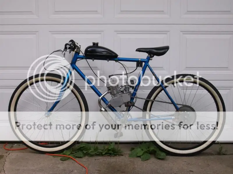

Here's a few pics of the bike I got running 2 days ago. I took the motor apart before I ever started it, the crank is straight as can be, although the bottom ring gap was way too close, (less than .002"), I filed it to .014", the top ring was fine, that bottom ring would have been a huge problem, can you say seize? Runs way better than I would have expected it to, starts right up, idles and has a lot of torque. I don't have the bike chain on in these pics, or grips, the kill switch wires are coiled up and hanging around the left side of the bars. It's far from finished, but I can't stop riding it. I'm on my 4th quart of gas already. Don't look too close, like I said it's far from finished. I will put a hanger on the muffler tonight. Those cables are WAY too long also.
