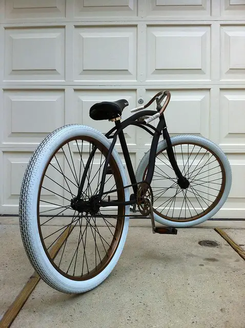

How mine sits while waiting for the 66cc race angle head kit from Piston Bikes to arrive.
Need to find a saddle and get a lay back seat post. Guess it wouldn't make much since to find a Brooke's that cost 2x as much as the bike, but dang they look good! I'll save that purchase for the Elgin build.

Thanks man! It's almost ready to fire up. Tried fitting the curb dog side pull brake to the fork to no avail. Pads wouldn't completely reach the rim. So for now it's flipped and mounted under the rear fender cross member mount. Better than nothing. I see you are from Portland, ME! Moving there in a year! My wife and I absolutely love it up there! And Alagash on draft! C'mon! She's currently there right now doing 3 photo shoots. We shoot for Maine Magazine and she recently landed all cover shots for Maine Home&Design.
Here's a few specs on the build:
-Jet 66c Angle Fire
-Puch Hi Hi compression head
-SBP Expansion Chamber
-Port matched intake/exhaust
-Repacked all bearings
-#41 Chain
-"Custom" layback seat post from good ol' Home Depot w/ Vintage Mesigner seat
-Cut/flipped/lowered bars
-White Brick tires
and how she sits while waiting for a few final things to finish up:
