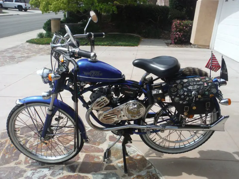

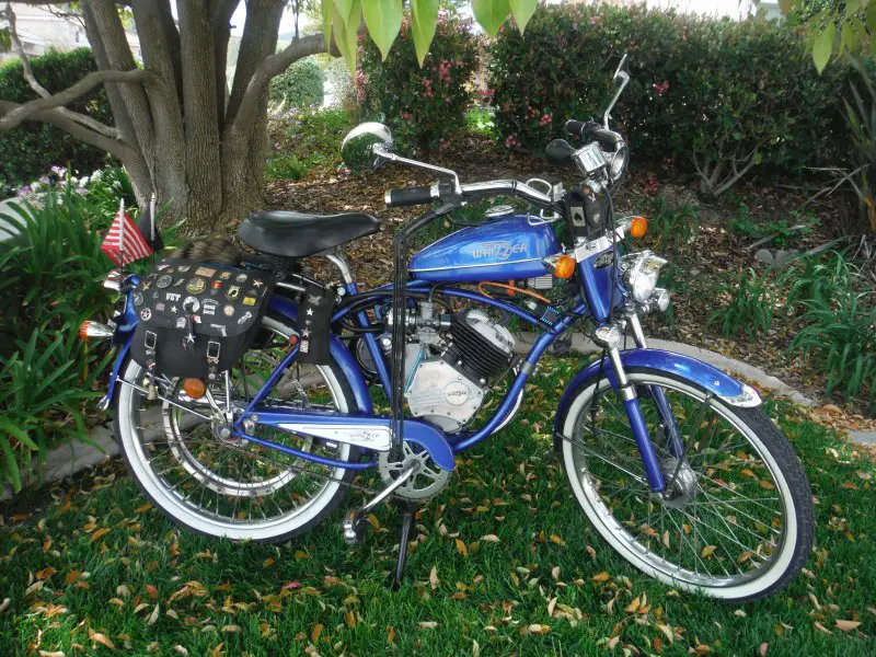

If your talking 4 strokes
Whizzer motorbike 138cc 4t side valve engine is the most compact because it's purpose made to fit in a bicycle frame
But buying a complete Whizzer or building a Whizzer M/B from scratch is gonna be alot more $$$$ than a Huasheng M/B Kit

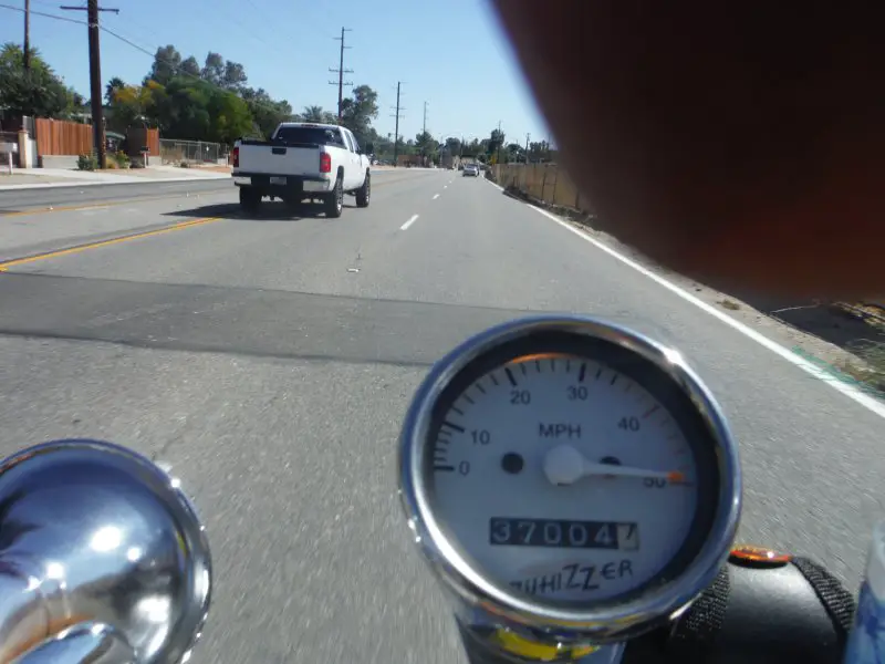

What about a used/NOS whizzer engine. Could that be had? What are they're HP, reliability and ability to use chain/sprockets?
I take it that the bike in the photos is you're bike. Looks like plenty of HP if you're doing 50mph for my purpose.
My Bike is a 2005 NE-5 with auto clutch - I've made performance modifications
Whizzer Motorbike is Belt drive

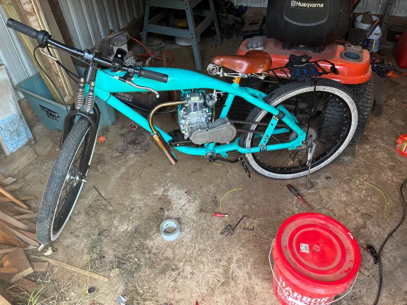

Wish people would have stuck to op questions would have been nice to have valuable information about that.
