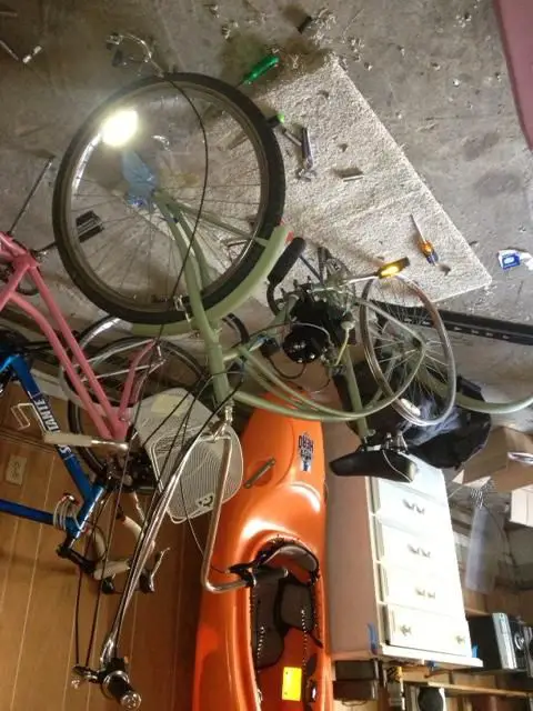

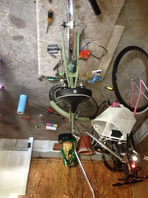

Hi guys, I just built my first bike and its alot of fun to ride when the motor decides to run right. I'm running into a problem where it revs all the way to the top with the clutch in, but when it's under load and i'm riding it doesn't want to go over what seems half throttle.
Specs:
Frame: old huffy good vibrations
Engine: Chinese 80cc 2 stroke Everything is stock except the briggs and stratton fuel filter (motor did the same thing before i changed the filter)
here are some pics:
