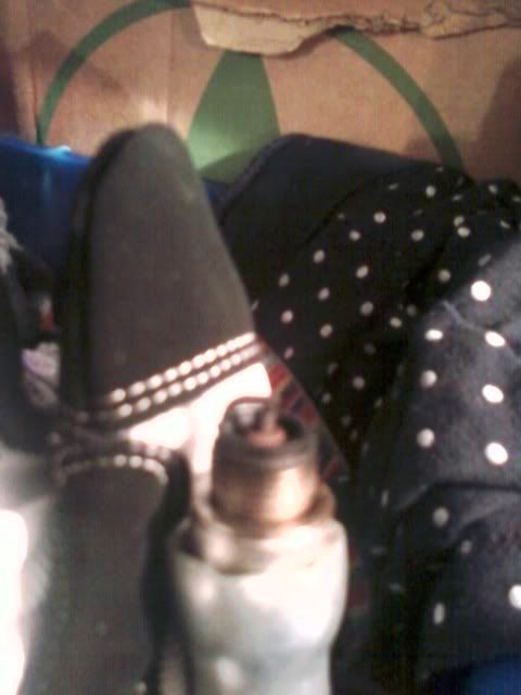

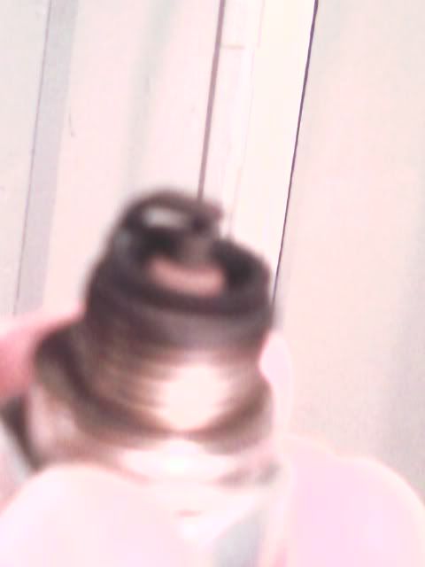

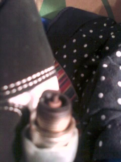

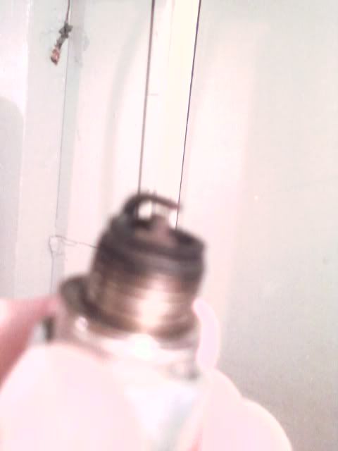

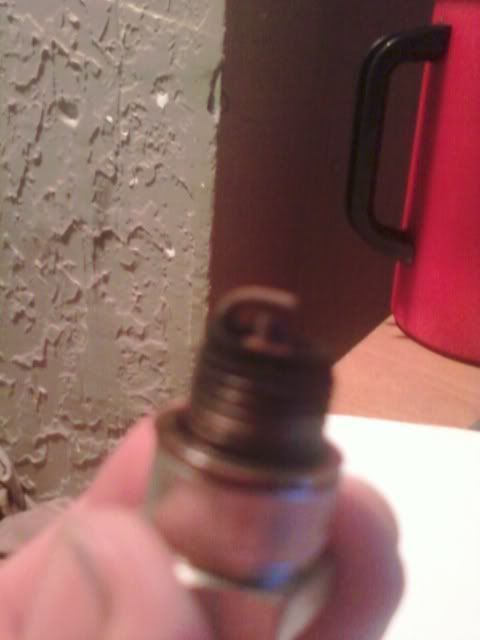

new pics How does this plug look
I know they are not very good pics but it's all I got here are the pics. If ya can tell at all what you guys think is it running a little to lean or am I reading it wrong
It looks fuzzy. Ha! hard to tell, but I think the color looks OK, maybe a little dark which would indicate rich. Chocolate brown is good, Swiss or white chocolate is lean and the dark chocolate or black is rich. Love that chocolate.
SB
i concur on the above.....how old is the plug?....electrode looks a lil thin but hard to say due to clarity of pics.....but on the flip side theres no deposits on the porcelin....gummy tar ....im not an expert on these yet as im still goin thru "breakin phase"....and id rather has a rich wet plug now than a dry one....just my own feelins....plus i live pretty much at sea level.......
This was after the first tank and it looks on the lighter side of chocolate. I am using power punch brand of oil I am running it at 25 -1 or a half cup to one gallon. Does anyone use this oil thanks and peace out
