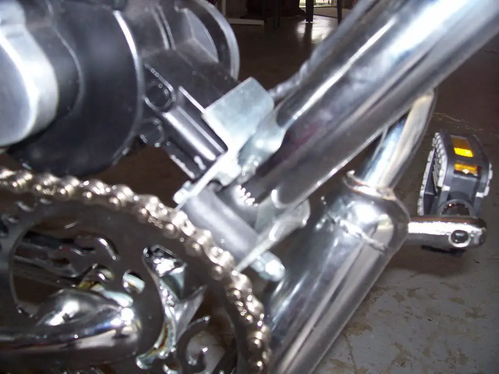

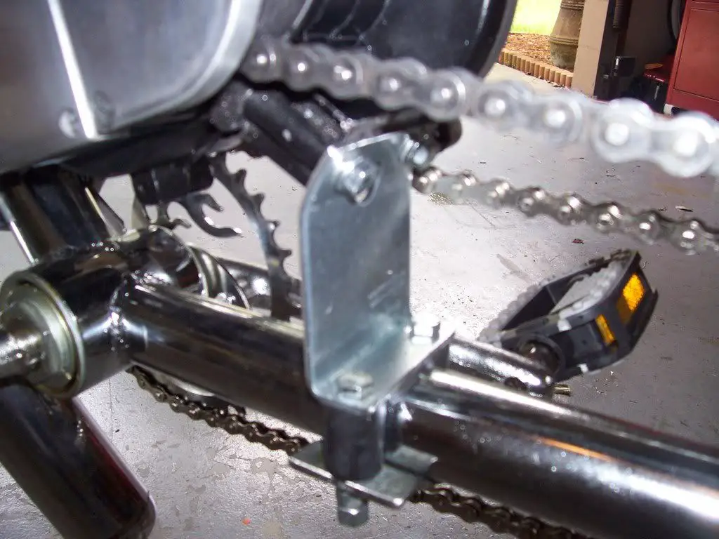

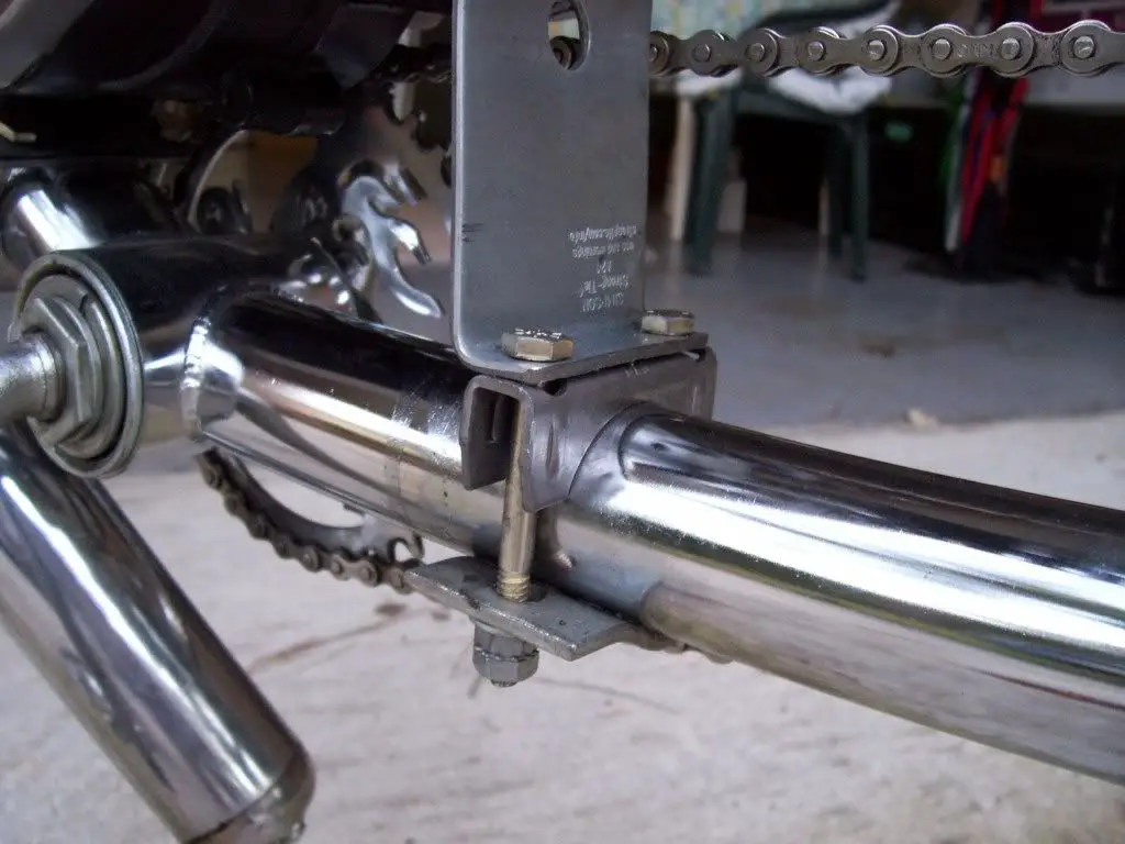

The mounts are made out of Simpson Ties (construction ties) purchased from Home Depot. I also added an exhaust clamp to keep the tube from wanting to flatten out. Here is a photo of the finished mount. The bottom bracket is the smaller half of a chain tensioner.
