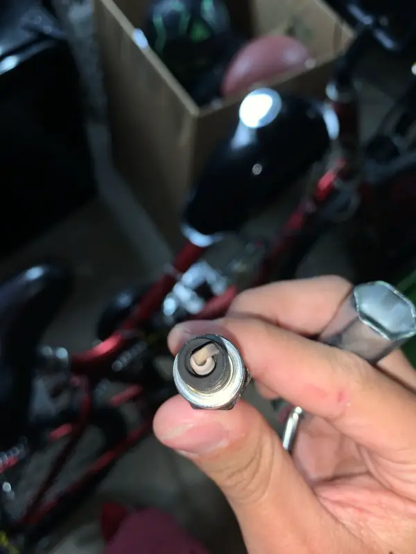

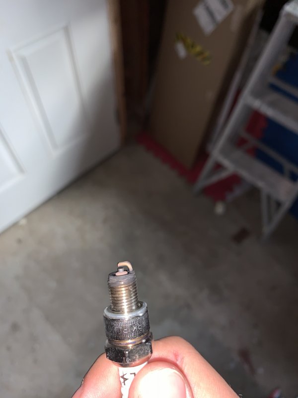

Hey all, I have a 53cc 4 stroke huasheng that I got installed. It wouldn't clear my frame with the outer part of the air filter box, so I left the inner part of the airfilter box on (just the side with the bolts exposed) and ziptied the foam on. It works well, but I would assume its running lean since it now has more air flow. When I tried to start it for the first time, it did not want to start at all. Choke or not. It would start if I gave it half throttle when pulling it, but then immediately die. Weirdly enough, turning the fuel screw 3/4 of the way out from seated allows it to start first pull and idle normally. Isn't this leaner? When I tried to make it richer, around 2 turns out, it would stall and die and white smoke would come out of the carb. Is this normal? So I put I put the fuel screw back on 3/4th of the way out and rode it for around 20 miles or so. I take the plug out and this is what it looks like. Am I running rich? lean? I've tried looking at the forums for answer and I couldn't figure this situation out.

Plug looks good and what you're thinking is a fuel screw is probably an air screw so it's the other way around. Out is more air. Leaner. In is less air. Richer.

On the huasheng carb? But the screw to adjust the air/fuel ratio is closer to the engine than the air intake side of the carb, doesn't that mean its a fuel screw? Im sorry, im new to these small engines and the concept of carburetors. Oh also by the way, when I took the spark plug out it wasn't a plug chop. Its the same plug ive been using since I first got the engine. That doesn't affect the info the plug can give you right?
