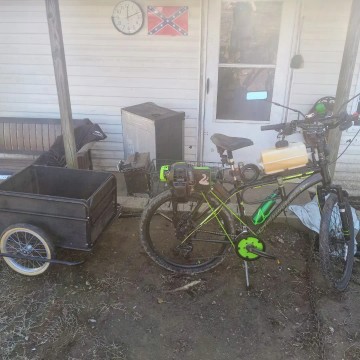

We'd like to see some pics and some specs on the engine and transmission. Oh and I use a 33cc 4 stroke and have a shifter bike with the widest reduction range in forum history (66.79-16.25\1). We don't have to have to used it; to tell you what to do with it.

Since you didn't provide any viable information about the tiller; I looked up the information.
The engine produces 1 hp at 7000 rpm. The idle speed is around 3100 rpm. The transmission has 1 forward gear and a 32\1 reduction.
If you don't alter the total reduction ratio, then these are the level ground speeds you can expect for the following tire sizes:
24"~15.6 mph
26"~17 mph
27.5"~18 mph
29"~19 mph

I looked up the specs on the Honda 31cc engine and tiller. It only has 1 hp. It's blade rotation is 194 at 6200 rpm; that's a 32\1 reduction. So in this case you're dealing with an assist engine.

The Robin Subaru 35 only has 1.6 hp. Yet I can do level ground speeds around 30 mph. If Recycler isn't a large person and/or have steep hills to contend with, this little engine and transmission is good for 15-19 mph depending on what size tires he's using. Many of us are happy with those kind of speeds.

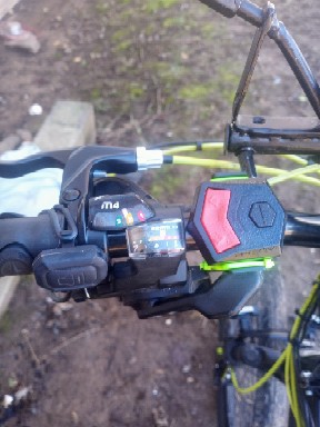

You have to go by each state rules, they are different. Like your bike here would be illegal, no manual shifting, all automatic, 20 mph tops according to the books. ....................Curt
My bike would be illegal in most places, due to being a manual shifter. However, my area is very lenient on enforcing the automatic transmission clause. It was for legal reasons I built the LandRider which shifted 7 gears automatically.
Here in Tennessee their main concern is you obey the traffic laws and stay under 30 mph on level ground and climbing hills. Going down hill you can go the posted speed limit.
I'm not required to have a Speedometer, mirrors, communication lighting, or a horn. Yet I have all these things for my safety. All Tennessee requires is a headlight for night riding and a red rear reflector.
