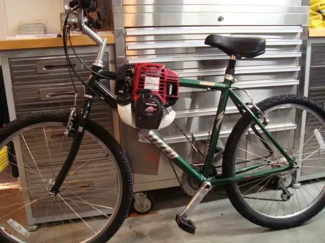

the MFG that makes the Kevlar Belt drive is Golden Eagle Bike Engines. I recommend staying away from that kit if you plan on climbing hills. Your best bet is making your own shifter bike. Both 5-7 and I have built them. They are ideal for hill/mountain climbing.
